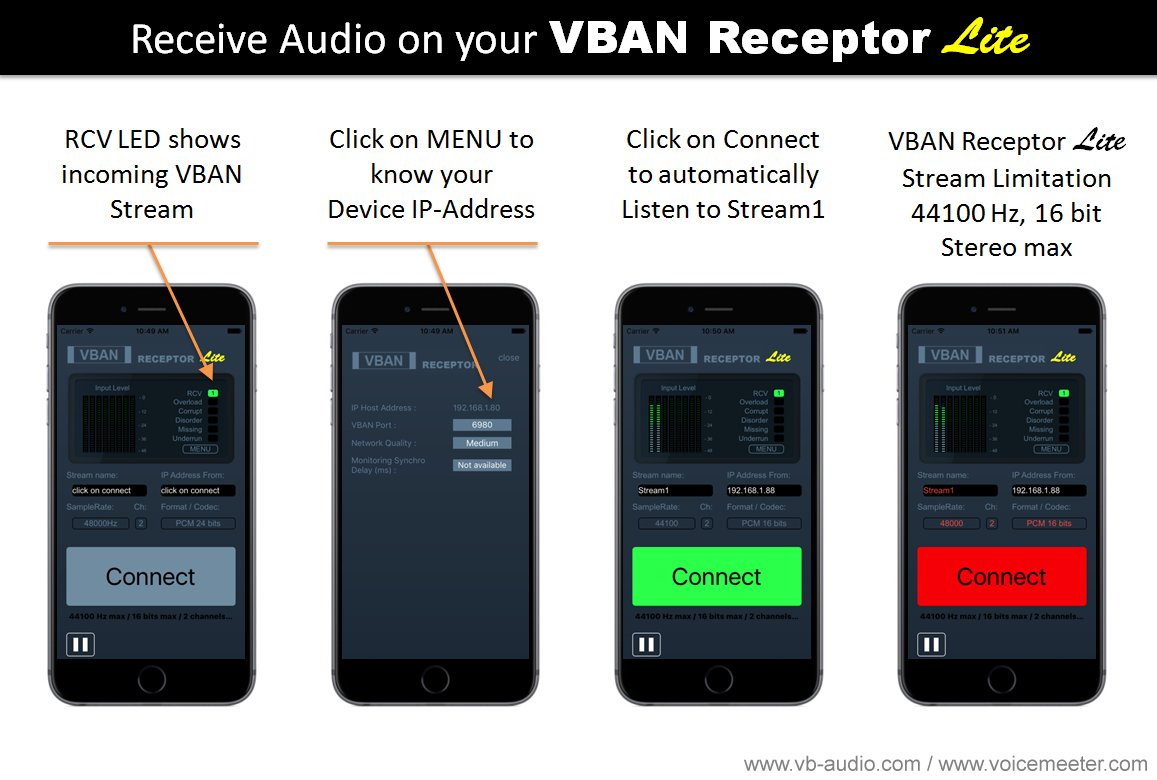

Re: Can't get VBAN-Spot to connect
On VBAN-Spot if there is a green indicator beside the ip-address, it means the stream is sent.
then you can see on receptor device that a stream is received.
so you have to click on CONNECT button on the Receptor Lite for example to activate the stream listening.
if it does not work, check your network ip Range, it must include the IP-Address of your device.
