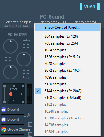

Virtual Audio I/O Latency can be adjusted to reduce the VAIO latency. For Voicemeeter VAIO, we recommend to keep internal buffer size around 4096 to 7168 samples. Reducing latency here is for expert and cannot be done without having read this technical note:
https://vb-audio.com/Cable/VBCABLE_ReferenceManual.pdf
Right click on Virtual I/O info field to get the latency menu:
