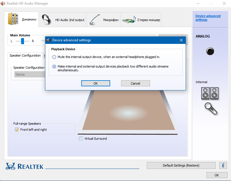

In my laptop audio settings I'm using internal and external channels separately:
In Voicemeeter Banana I assign them to A1 and A2.
The issue is, Realtek drivers remove the sound device for headphones once they are disconnected.
Voicemeeter isn't really happy about this, but prior to the last update it didn't freeze at least.
Now, after I disconnect the headphones, there is no sound until I kill Voicemeeter in the Task Manager and start again.
