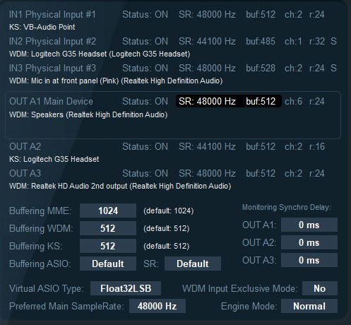

I have 2.0.4.4 installed and everything in windows set to 16 bit/48000 hz except my G35 headset which can only do 16/44000 hz. I also have the virtual cables set to 48000hz.
The problem is that banana is showing the resolution strangely or incorrectly for multiple devices. It's showing multiple devices at 24 bit and my usb headset that can only do 16/44khz shows 32 for resolution?
Is there a way to correct this?
Also what is the "S" after the resolution after a couple of them?
Here is a screenshot
Thanks!

if the device is opened in share mode ('S') the audio format is given by the kMixer (usually working in 32bit float)... that's why you have r:32
If you have no sound problem, you have not to pay attention to format negociation and resolution.
