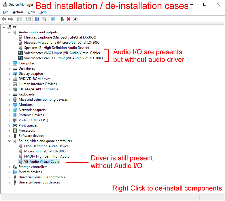

MANUAL UNINSTALLATION
In some cases, audio driver can be bad installed or partially de-installed and prevent to have an audio system running correctly.
Before re-installing our VB-CABLE or Voicemeeter, it's important to check that the related audio drivers are correctly removed from the system, in the Windows Control Panel / Device Manager:
if you find some part of it in the Device Manager, you may right click on it (to get contextual menu) to de-install it manually, by the windows procedure.
Start by the Sound Controllers (and reboot after)... then check the Audio I/O and possibly remove them by the same way (right click on it and deinstall device).
After a last REBOOT (PC restart) if the Device manager shows nothing else, you can re-install our VB-CABLE or Voicemeeter (and don't forget to REBOOT your computer after).

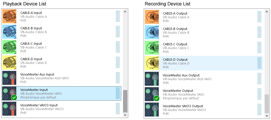

Recommeded re-installation step by step:
1- unplug all USB audio device + REBOOT.
2- de-install VB-CABLE one by one + REBOOT
3- de-install Voicemeeter + REBOOT
4- check your remaining audio devices are working ok.
5- check there is no presence of our virtual audio driver in Windows Device Manager (in both sections: multimedia controller and audio input output).
THIS IS THE CRITICAL POINT: you may find no reference to Voicemeeter (or VB-CABLE) in Windows Device Manager
(nor in Multimedia controller, nor in audio i/o section).
6- re-install VB-CABLE and Voicemeeter one by one , REBOOT after each operation, check your device list in Windows Sound Dialog box.
7- when all is re-installed, re-plug your USB audio device. check again your default playback and recording device
8- Run Voicemeeter and check systray option. Audio should work again correctly.
Anyway your VB-CABLE or Voicemeeter VAIO's must appear like on the picture below for Playback and Recording Devices. Otherwise you should re-install them correctly.

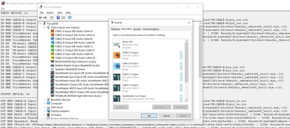

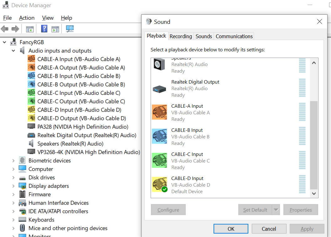

I tried again today to uninstall / install per instructions and the same audio glitch and visual glitch occur. I think it's Windows just being corrupted somewhere with that recent update. I have the latest software versions.
After A-D installed, Before VM
After VM installed - the listing appears right in your app but the icons in Windows are messed up.

MinuitPro
Posts: 6
Joined: Tue Mar 24, 2020 10:33 pm
Re: VAIO / VB-CABLE Installation Checking
Post by MinuitPro »
Vincent Burel wrote: Sat Apr 17, 2021 9:12 am you may de-install Voicemeeter and VB-CABLE... +REBOOT
then finish to de-install them manually in the Device Manager as explained in first message... +REBOOT
then install them step by step. with a REBOOT and checking after each install.
That's what I've done, twice.
The only difference is when I uninstall VB-CABLEs, they are no longer in the Device Manager so there's nothing to remove there.
