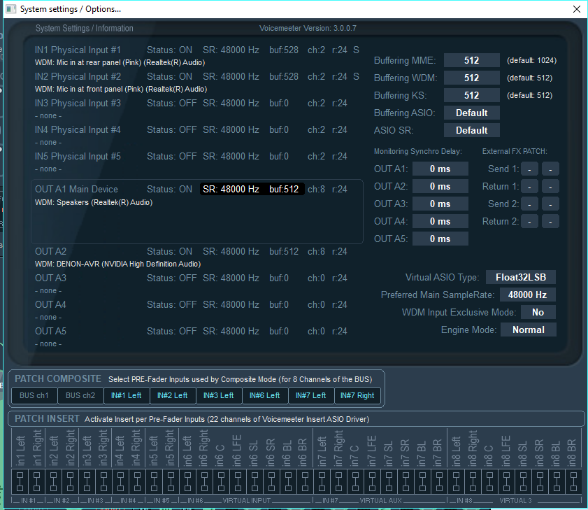

For my testing I do have the AVR on BUS A1 and have confirmed voicemeeter shows 8 channels.l in the settings.

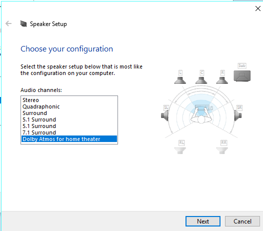

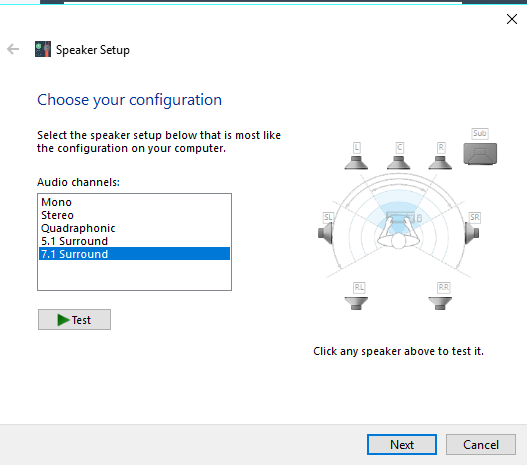

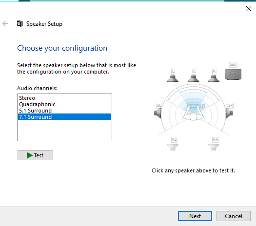

attached are the speaker configs...more screens to come.
NOTE: although the screenshot of the denon shows that the rear channels are disabled I did re-enable them and executed the tests with no Joy. AVR still shows "Multi In" / PCM.
- voicemeeter-input-speaker-config.png (25.2 KiB) Viewed 43376 times
- denon-speaker-config.png (24.13 KiB) Viewed 43376 times
- realtek-speakers-config.png (24.41 KiB) Viewed 43376 times

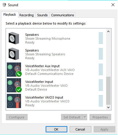

windows sound device and voicemeeter configs
- voicemeeter-settings.png (92.1 KiB) Viewed 43376 times

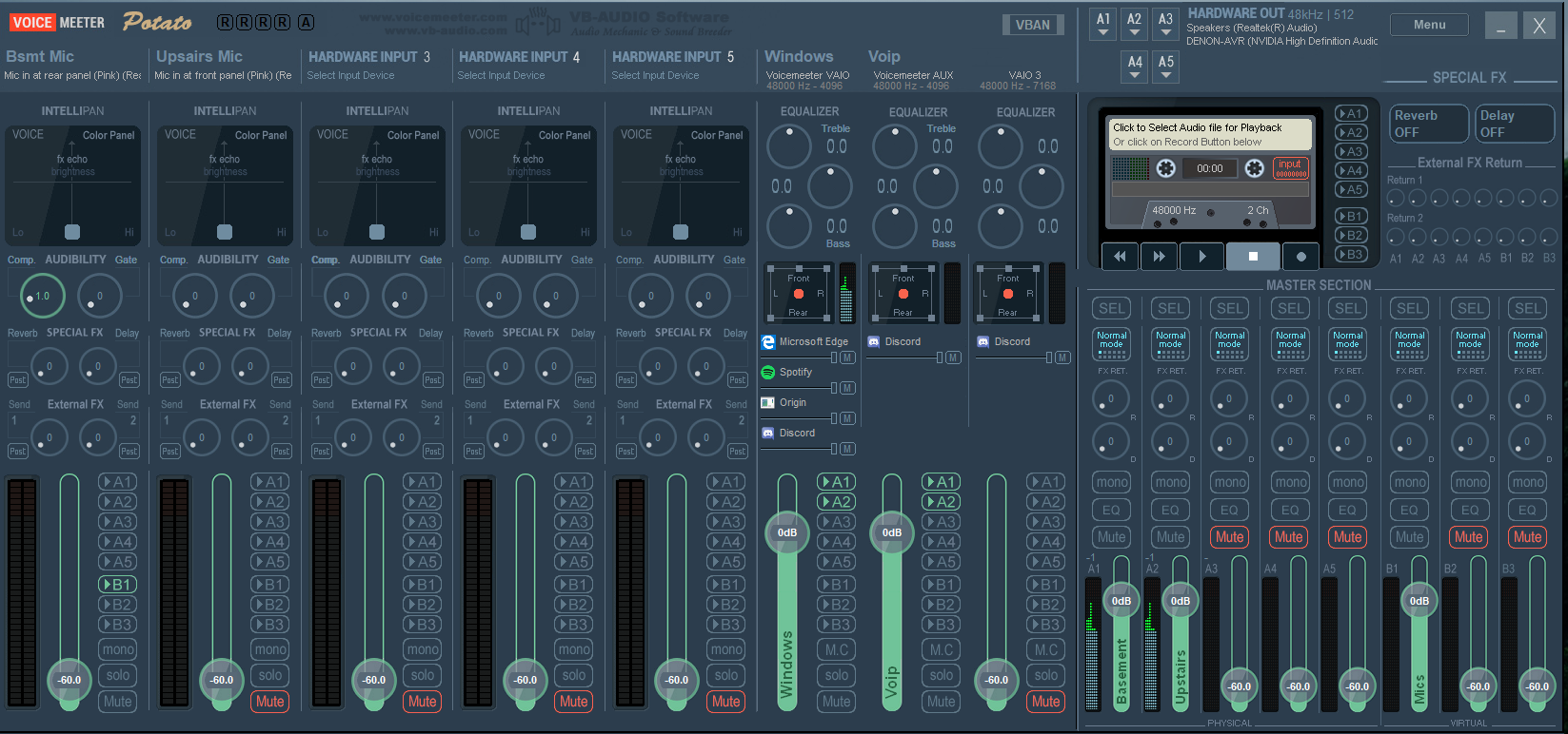

- voicemeeter-main.png (211.8 KiB) Viewed 43376 times
- windows-default-sound-device.png (27.7 KiB) Viewed 43376 times
