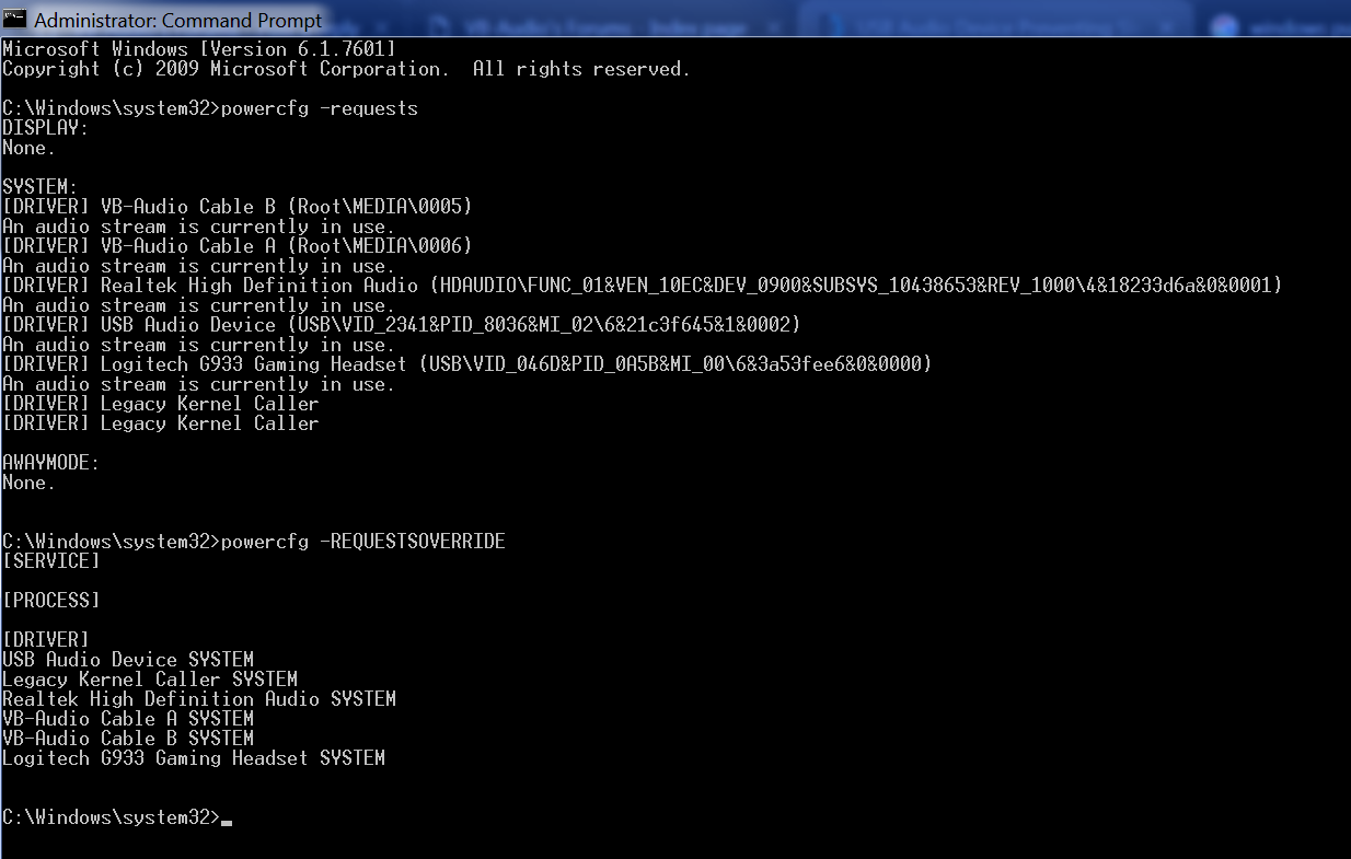

based on some googaling and this SuperUser question i think that the driver is stoping the shutdown (and automatic sleep but i never use that) because voicemeeter is holding the audio stream open
as per the mentioned SU question i have tryed to override the drivers stopping shutdown but that also hasent worked i have tryed scripts to close voicemeeter befor shutdown but i cant seem to get that to work. for some reason it does not rlease the driver eaven when shutdown. i think it is the Legacy Kernel Caller driver that is messing up.
