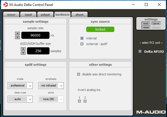

well, we have M-Audio Delta, used for our Voicemeeter test, we never got problem.
please , let me know your exact configuration for the M-Audio Board (screenshot if possible)

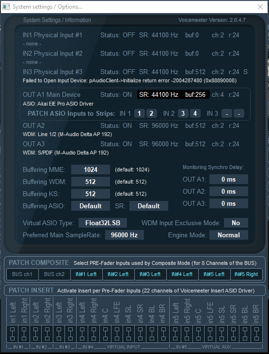

and send a screenshot of Voicemeeter System settings Dialog box.
we will try to reproduce yoru problem.

Here's the configuration.

you may set the M-Audio ASIO buffer size to 512 sample instead of 256
if you use more I/O of your M-Audio device, it could be better to use it as output A1...

Now will I be able to keep the EIE pro as ASIO if I put the Delta as A1?
That's the only way I know of to be able to use all four inputs of the EIE pro.
EDIT:
Tried that and it didn't work.
Tried setting the Delta 192 as A1 and I couldn't set the EIE on A2 as ASIO.
EDIT:

Well the latest Windows 10 feature update installed and it broke my audio so I thought.
I wound up having to reinstall the Delta card and now its input works in Voicemeeter Banana like it should.
I ran into another problem though.
V-IN-2 Voicemeeter AUX is showing no driver present.
I saw where the VB Audio virtual cable was no longer installed so I installed it.
Seems to have made the V-IN-2 work although it still shows no driver present.

Re: Voicemeeter Banana issue
Hello!
I was with the same problem and I turned what's inside of red circle to YES and solved my problem.
Cya, thank you.
Cya, thank you.
