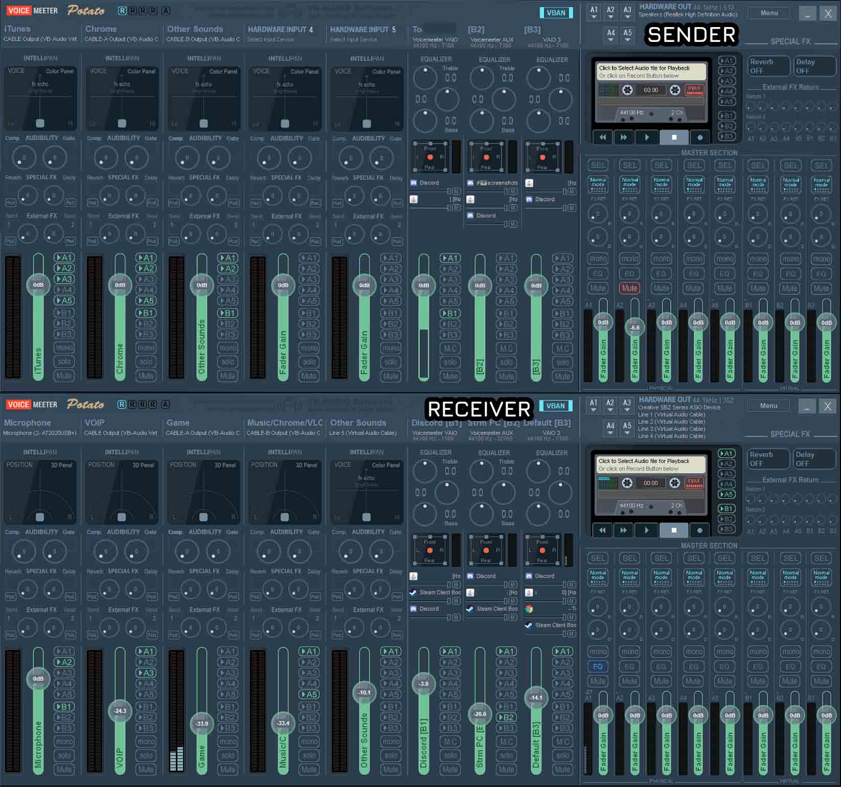

I use 2 computers while streaming. I use the 2nd PC for music and send it over VBAN to my gaming/streaming PC. I also send Chrome audio.
I am having trouble with random errors that result in audio having small blips and stutters. The errors usually show as missing or underun. Sometimes it will start straight away, sometimes it will start over time. It just seems random and what I am doing when it happens vs. when it's not happening doesn't change.
I run 1gbit wired network, the PC's are both more than powerful, I am not taxing the network - only I am using the network. Using the "restart audio engine" option in VM does nothing. Rebooting the PC's is the only thing that really works, but that isn't really an option mid stream.
I read a post from over a year ago about errors creeping in over time. Is this still the case?
I have attached some screenshots of the settings for both computers. I have tried different settings. I have tried the different network speed settings and all that. They all seem to start exhibiting errors at some point

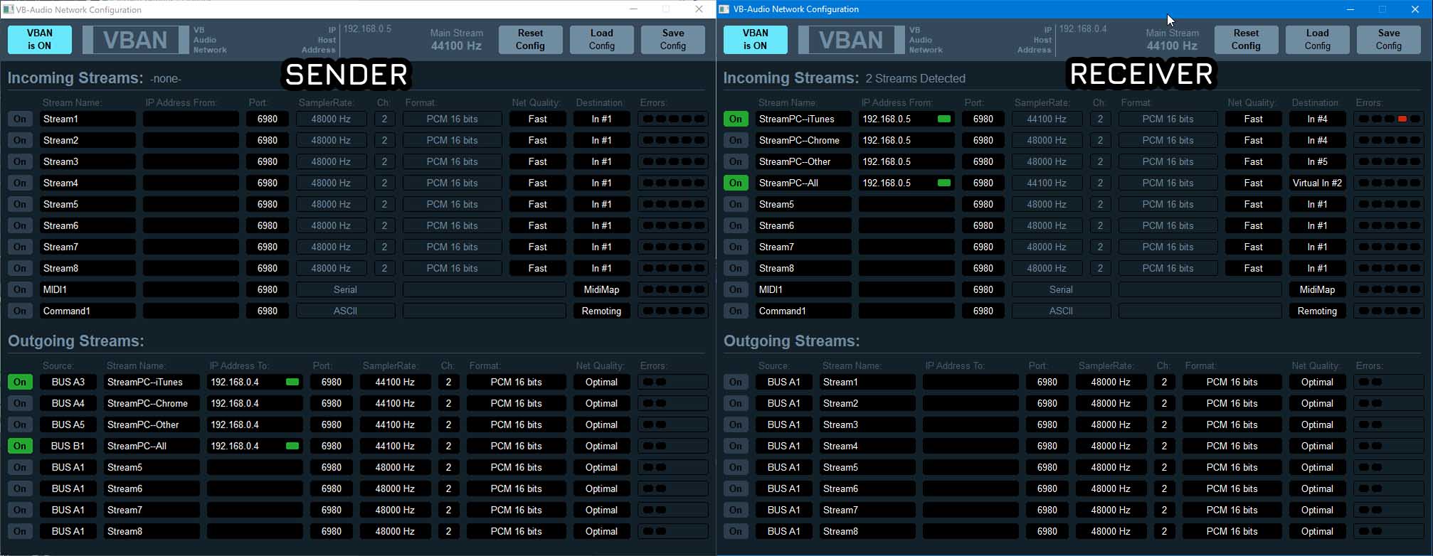

anyway, if you want more help, you may post screenshot of your voicemeeter VBAN dialgo box at least and explain where is located the problem.

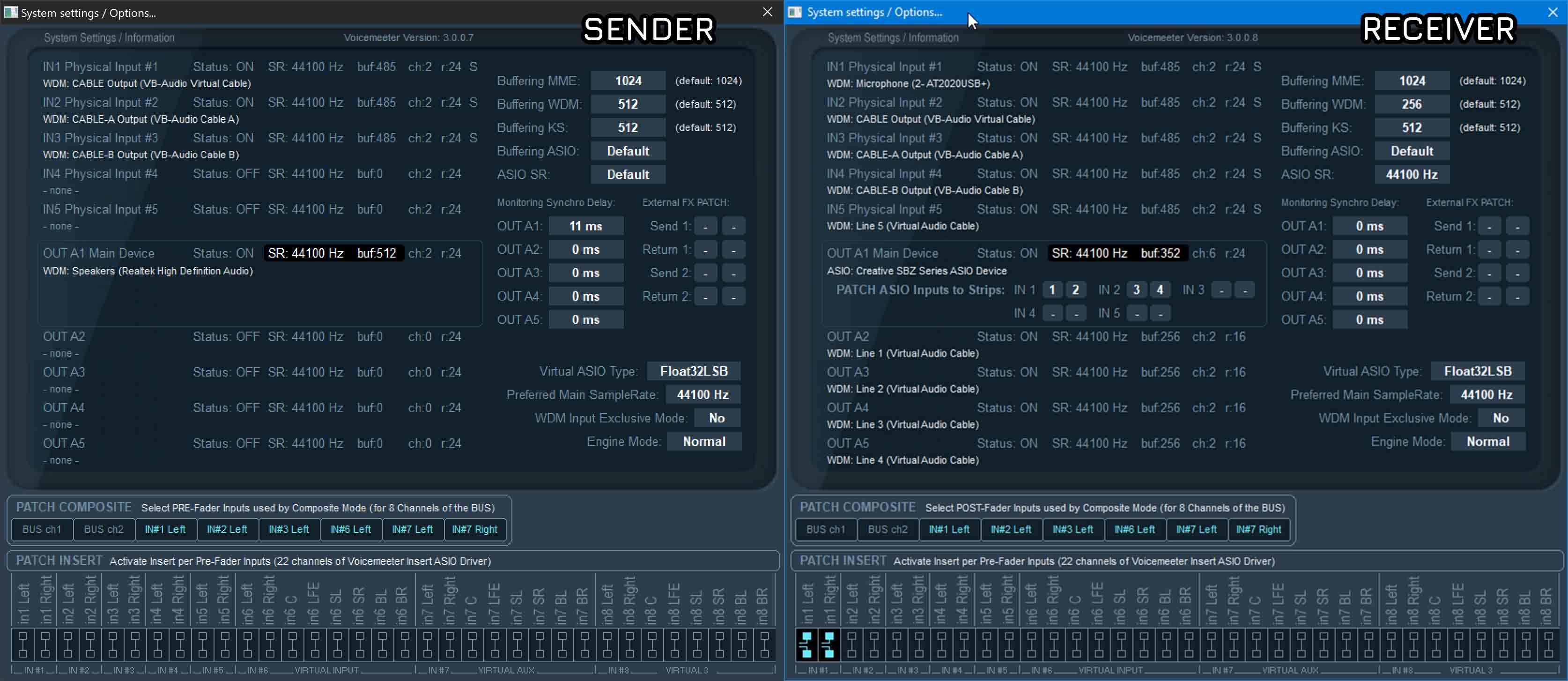

I posted an Imgur link in my original post with screenshots of the VM settings on both computers. I will post them as attachments though.
The IP/Subnets are 192.168.0.4 / 192.168.0.5 and subnets of 255.255.255.0 for both machines.
I tried setting both sides "net quality" to medium last night, and for 8 hour, I had virtually zero errors. Today I have booted the computers up to stream again and it is throwing a lot of errors again, even though nothing has changed.

ok, so the problem is maybe not coming from VBAN but one of your voicemeeter running unstable...
if it happens again, check that your Voicemeeter output A1 is running correct
(for example by playing an audio file with the integrated recorder).
if the Voicemeeter main stream (output A1) becomes unstable, all other stream will become unstable so you may follow recommendations there:
viewtopic.php?f=6&t=451
however the 4th RED LED means "missing frame" , meaning the network lost packet... so maybe the problem is more on the network.
(2nd to 4th RED LED are usually error due to network - while 1st and last LED can also be due to audio stream stability).
LED 1: overload (VBAN stream early clock error)
LED 2: corrupt (very unusual)
LED 3: order (very unusual)
LED 4: missing (problem on network)
LED 5: underrun (VBAN stream late clock error)

After learning that everything with VM is tied to the functioning of A1, I paid more attention to the status of that and the Windows device it pointed to... my Sound Blaster Z. I was finding that for whatever reason, even though I set the sample rate/format to 16bit 44100hz, it would random go back to the default it seems to prefer being at, 24bit 48000hz.
I *think* so long as I ensure that all devices on both computers are set at 16bit 44.1, it all seems to be working reasonably well.
I always thought that I had been keeping on top of making sure all devices were set correctly, but there is a chance that the times it started throwing errors one device maybe switched to something else and that is what may have been causing it.
