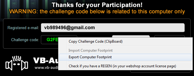

- Posts: 2204
Re: INFO About FootPrint (Potato Activation Code)
You can export footprint on a activated license only as the picture shows in a previous message above.
you may store this footprint on an external disk or USB key.
Then after having re-installed your PC, Windows, driver... and finally Voicemeeter Potato.
if you have not the same challenge code, you may import the previously stored footprint (right click on Challenge code field) to get back your previous challenge code (fitting your current response code).
STEP BY STEP, you must:
1- Enter the same e-mail address before importing the footprint.
2- Import the footprint
3- Enter your previous Response code.
