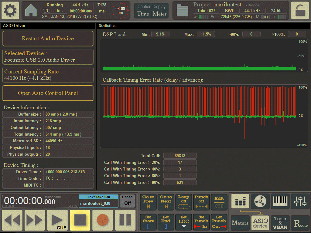

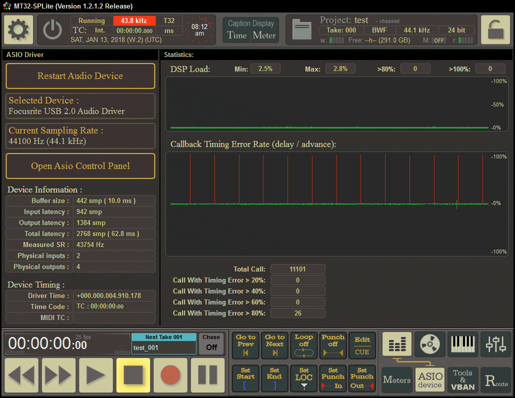

The MT32-SPLITE (and MT64 or MT128) application shows the problem in its ASIO page, when selecting Focusrite ASIO Driver. For example with Focusrite Saffire USB, even with a big buffer size (942 samples) the ASIO driver is sometimes calling the process function twice and consequently is producing timing error (red peak).
We also have Focusrite Scarlett 18i20 connected on a MT128-PRO (64bits) on WIN7 64bits. We set down the latency to 89 samples buffer size (producing a global latency of 13.9 ms which is much bigger than expected for this buffer size). And we can see that the timing errors are more important if the buffer size is smaller. (similar problem reported on Scarlett 2i4 MK2).

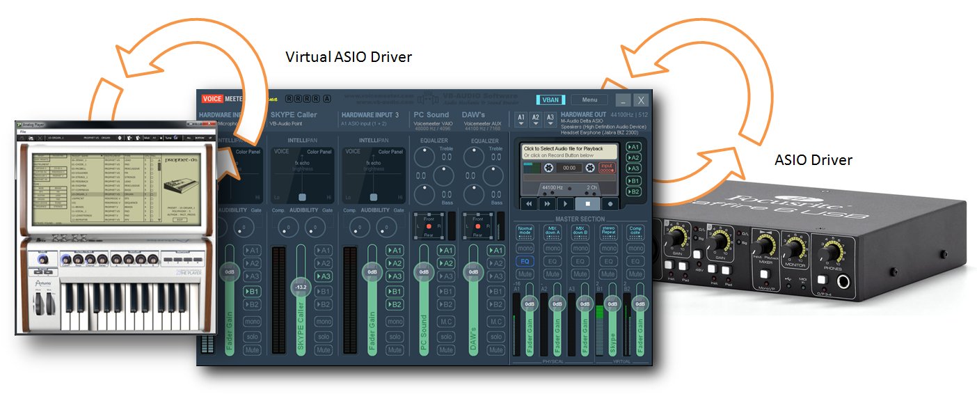

The problem is more present with Voicemeeter Virtual ASIO Drivers (allowing to connect a DAW or ASIO instrument to it), which are strictly synchronized on the Voicemeeter Main Stream (given by output A1 device), that can be driven by a focusrite ASIO driver.
Since ASIO interface is based on a double buffer swap principle, it is important to have enough time between buffer swap to process it and respect real time constraints. With Focusrite ASIO driver, the buffer swap can be done without respecting this timing and then will produce an audio cut/crack on the DAW source connected to Voicemeeter virtual ASIO driver.
