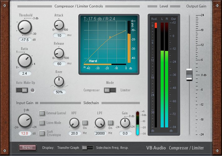

Just want to add: reading 6) reminds me of how much I've always wanted attack and release times for the input compressor/gates.
I mean, yes, I know I could run something like Carla (VST host) and then host another VST(i) and use the FX send/returns. I'm familiar with audio production and it's not alien to me it's just....a lot of work for an attack/release envelope. The built-in compressor/gate have so much potential in theory, but in practice tend to not be not so useful. Honestly I could solve my issues by just buying better hardware and not using onboard audio interfaces but.... It's so close to perfect, and yet, so far.
Would adding envelopes to the channel FX be a possibility?
- Posts: 2205
Re: My Feedback on 3.0.1.2
there is true compressor in Voicemeeter, we just resume it in a single button.
If you need VST just to get a complete compressor, we can think about providing an advanced dialog box like this:
xcasxcursex
- Posts: 173
Wow where does that image come from? Something like that in voicemeeter would be amazing
- Posts: 2205
well, I developped around a hundred of plug-ins between 1997 and 2005:
https://vb-audio.pagesperso-orange.fr/F ... /index.htm
will think about... implementing a full compressor advanced dialog box in Voicemeeter Potato could make sense...
