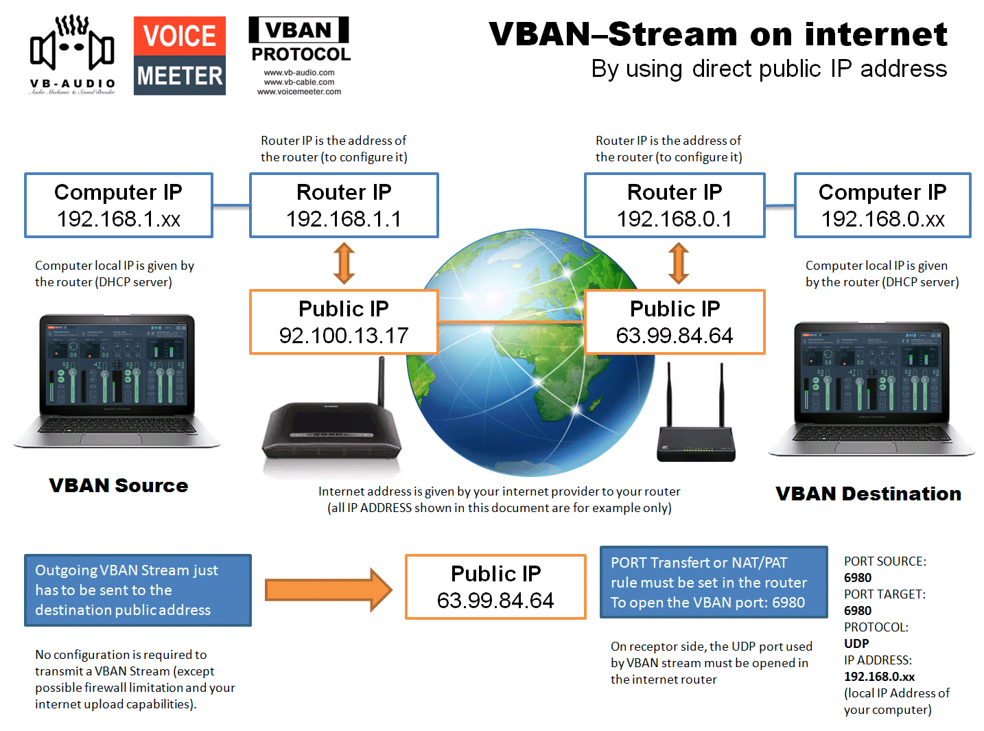

yes, we just made a small picture explaining all the things around IP-Address Management to transmit a VBAN Stream (see below).
There is basically 2 points to know:
On transmitter side, you must send VBAN stream to public address of your destination.
(you may ask him his public ip address - just type "what is my ip address" in chrome for example).
On receptor side, internet router has to be configured to open the VBAN UDP port 6980.
(this is usually possible thanks to NAT/PAT rules or Port Transfer rule in the advanced/network configuration page of your router).
