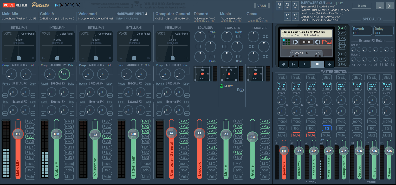

well, you may post some screenshot to let us see your configuration (voicemeeter )
we could see if there is potential problem on your configuration and tell you you could try.

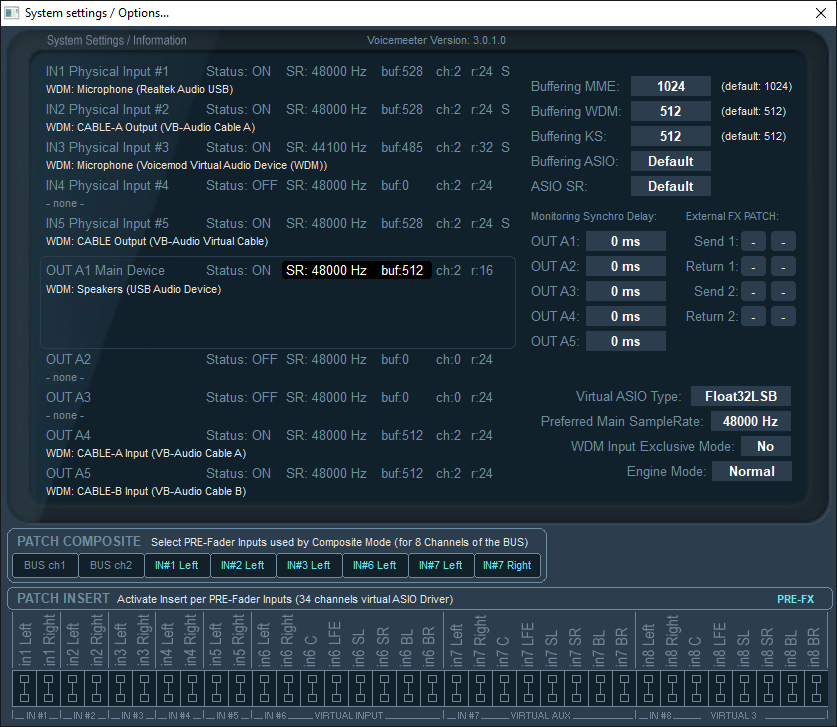

Re: Stuttering from VC-Cable
Sure thing. I also want to confirm OBS is not part of the issue since it's doing it right now with nothing running but spotify.
Also, to clarify, Cable A on input 2 was not originally there, issue still persisted. I just added it to check if I could hear the issue by looping it back and through my headphones (and I can).
