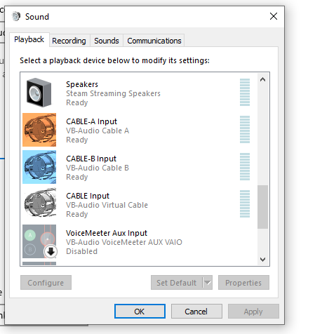

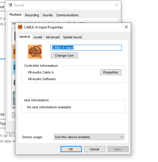

I attached a photo of what the sound control panel, I think that's what you mean. It's showing "ready" and "enabled" there and under the control panel properties under all tabs.

Re: No longer showing up in sound settings
so you can see for example that Voicemeeter Aux input is disabled...
Right, but that's purposeful. I don't use voicemeeter. It's great for live streams, but I do more recording which VAC seems to work better for so I can record multiple audio tracks and edit them individually in production.

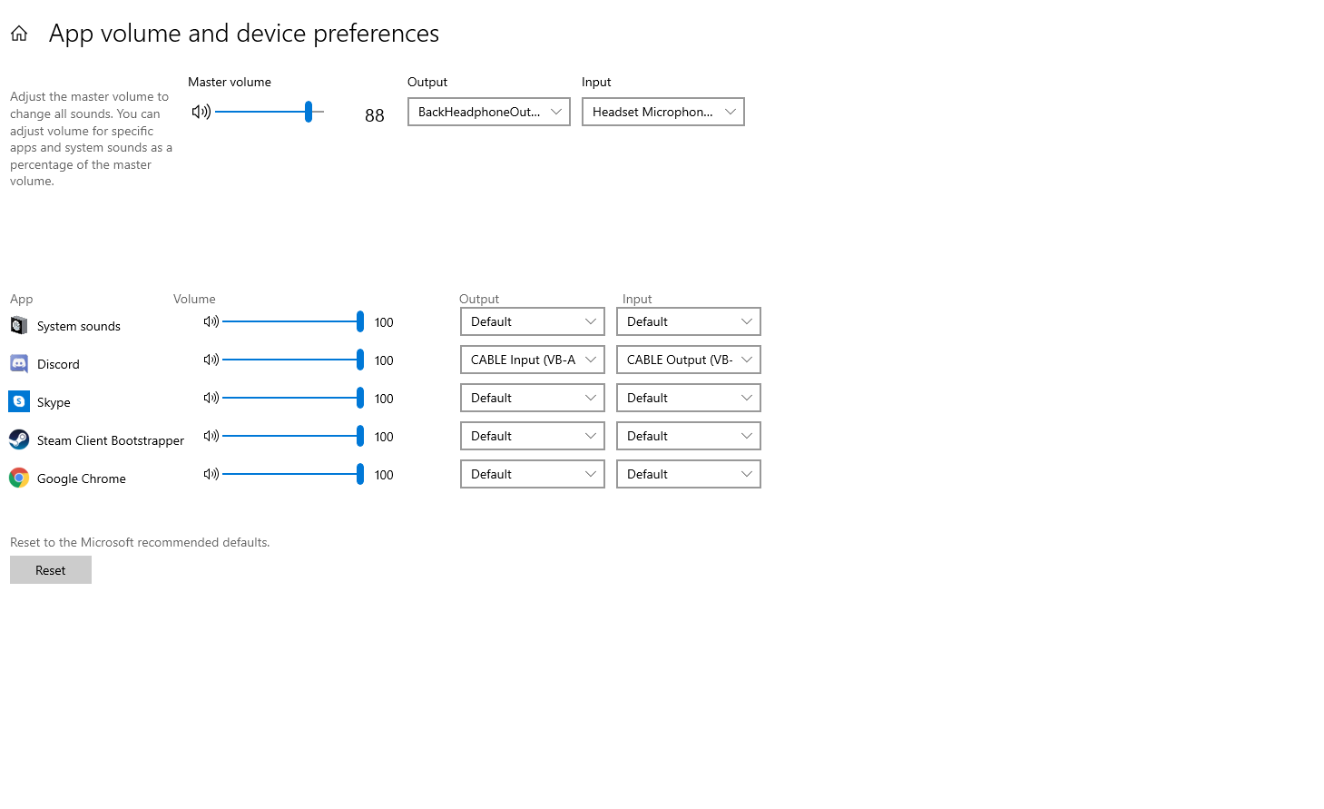

I used to see it in the location listed below (I know it might not be set up correctly there, I was just fooling with options to see if anything worked). I would route the audio output within the application (if available), such as Discord, through one of the VAC's and use this to route it from the output cable to the headset output. SLOBS would pick it up in between the cable input and output.
So, basically the issue is that I have no way to route the VAC output to the headset or default output.
if the device is correctly listed "enabled" in the Sound Dialog box, it should be usable.
maybe you want to do with Windows soemthing not allowed...
but this is the purpose of Voicemeeter.
VB-CABLE is a simple cable to connect 2x applications together (a player to a recorder) if you want to do more, you may try Voicemeeter.
to do that you may use the LISTEN option of Windows to route a Recording device to a playback device.Mack92011 wrote:So, basically the issue is that I have no way to route the VAC output to the headset or default output.
