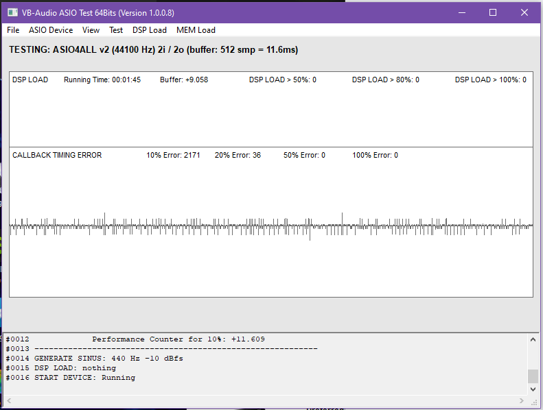

When I run the ASIO Test This is what I receive for ASIO4ALL when I'm forced to use if I want to use VoiceMeeter and it causes all kinds of sound glitches and lag that I need to restart constantly to fix. I also can't hear the tone in either test.
When I run the test with the specific driver for my M-Audio MTrack 2x2 I don't get any feedback from the test.
The screenshots are similar for 32bit version of the test if that makes any difference.

I'm not sure what log you're referring to specifically but in the ASIO Test this is the results I get:
I first test my ASIO driver and then I test asio4all it's the same results for the 64bit one. I'd continue to use asio4all driver but the latency and static it produces is unmanageable. Again still unable to hear the tone with my ASIO driver, I was able to hear the tone using asio4all but it was full of static.#0001 ------------------------------------------------------

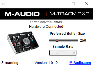

- Posts: 2203
Re: Can't choose ASIO as a hardware out - M-Audio MTrack 2x2 (windows 10)
ok seems to work correct - except the driver is not running (no buffer counter increased)
the sure point: your M-Audio device is configured with 64 sample.
it's maybe better if you configure it with 256 sample buffer latency at least.

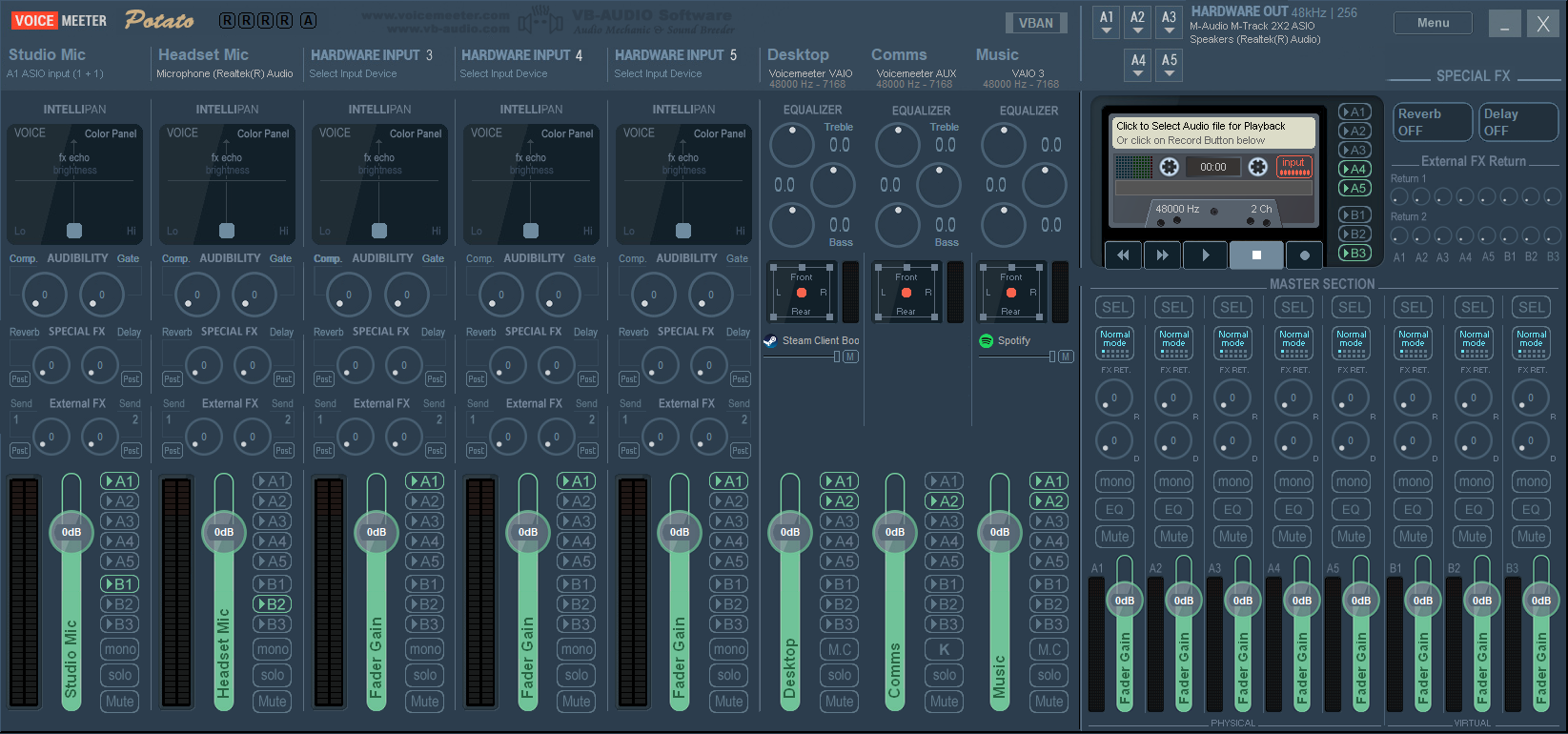

Just here to add that I have the same issue with the M-Audio M-Track 2x2 interface. Choosing the ASIO interface results in no sound through the entire application, including other WDM inputs and outputs.
I am confident everything outside of Potato is set up correctly - my entire system is set to 24 bit 48k, the ASIO driver is the latest. The ASIO driver works in Reaper and other programs. It just doesn't work in Potato. Here is the screenshot of my settings. I've also ran the ASIO test tool in both 32 bit and 64 bit and have gotten the same results as the previous poster (that is, no results).
The last thing that I noticed that was strange is the M-Audio driver alternates between "Streaming" and "Not Streaming" every few seconds when I select the ASIO driver in Potato. While when I select the WDM driver it is constantly showing "Streaming". When ASIO is selected in Potato, the settings screen also flashes every few seconds when I have it open, corresponding with the connect/disconnect showing in the M-Audio driver.
Please let me know if there's any more info I can provide. Thanks for your help!
