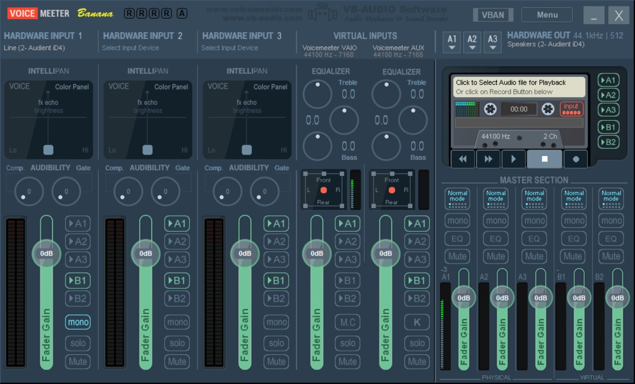

Re: Searching for Voicemeeter Expertise ?...
Hi Andres I attached a screenshot of my Voicemeter window for you to look at. I have made sure that all effects are disabled in Voicemeter, Windows sound control panel, and sony vegas itself. As previously mentioned this problem only occurs when I want to record in sony vegas itself, in all other applications Voicemeeter works fine as it should. So we should look into sony vegas itself and maybe try diffrent inputs/settings.

- Posts: 192
Thank you LowRarri. Since Audio device type is set to Voicemeeter Virtual ASIO, Vegas output is connected to Voicemeeter Virtual Input labeled Voicemeeter VAIO. This is explained graphically in Voicemeeter Banana User Manual. (See section Voicemeeter Virtual ASIO driver in page 14). It could be possible to create a loopback. See the red warning.
Try this:
Try this:
- In Hardware Input 1 temporarily disable A1 button. You won't be able to listen your microphone while recording (We should check if you are using Input Monitoring in Vegas or your Audient interface monitor mix knob)
- In Virtual Input Voicemeeter VAIO temporarily disable B1 button. B1 bus will transport only your microphone signal to Vegas.

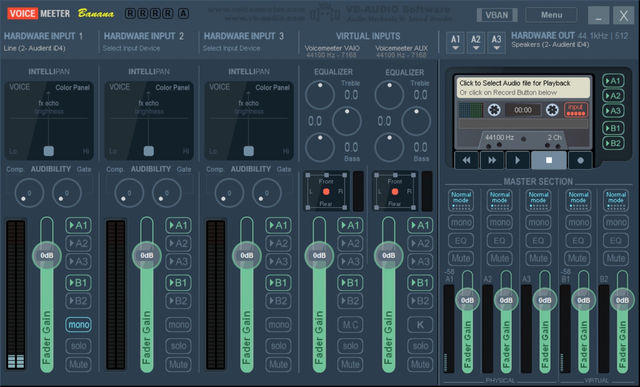

LowRarri
- Posts: 6
- Joined: Mon Jun 29, 2020 11:57 pm
Hi Andres I attached a screenshot of my Voicemeter window for you to look and yes the recorded audio does still sound deeper then normal. I looked into the Voicemeter VAIO virtual input and the meter bar is working as it should when I was playing back the recorded audio, the meter bar of the A1 output was not moving at all but that always happens when im using another application at the same time such as Sony Vegas as the attached screenshot will show you.
- recorded audio in Voicemeeter.jpg (239.65 KiB) Viewed 220614 times
- Posts: 192
Hi LowRarri. The screenshot shows a stereo signal into Voicemeeter VAIO virtual input volume meter bar (I understand this comes from Vegas) but it also shows a stereo signal on A1 output which is connected to your Audient iD4 where your headphone is connected. You should be hearing a stereo signal.
