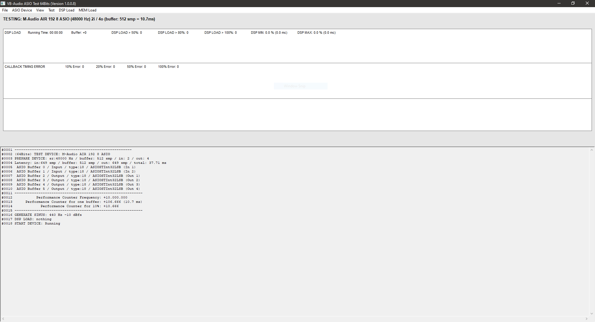

BirdO
- Posts: 5
- Joined: Tue May 05, 2020 1:24 am
Re: No sound with ASIO device
Alright did the test. I took screenshots. Looks like something isn't working. Tested with Ableton though and still works fine with that.
- 64 bit test
- 64bit.PNG (44.56 KiB) Viewed 23105 times
- 32 bit test
- 32bit.PNG (66.92 KiB) Viewed 23105 times
