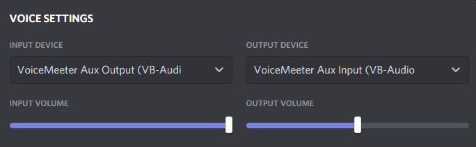

You picture implies you are looking at recording devices but I assume you want to playback your virtual tape to Discord, based on your picture.
The selections on the right are for output (playback) devices. If you input device on Discord is B2 and you are trying to playback audio on discord, you need to set your input device on Discord to VoiceMeeter Aux Output. You can do this in your Discord Voice settings.
If however, instead you want to record from Discord to your virtual tape, then you need to have Discord Output to Voicemeeter Aux Input.
In your Windows Sound Settings, also, make sure your Discord inputs and outputs are set correctly. I found what Windows shows doesn't always match what Discord shows. In that case, I'm not sure who wins out.

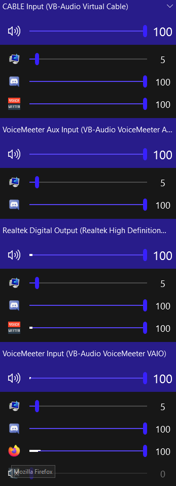

Re: B1 and B2 not connected to virtual recording devices
I have it working fine on my primary system btw. Secondary system just refuses to have B1/2 output to Discord or OBS (or anything else other than VBAN output).
- VoiceMeeter-Mixer.png (32.75 KiB) Viewed 20994 times
- VoiceMeeter-Discord.png (12.6 KiB) Viewed 20994 times

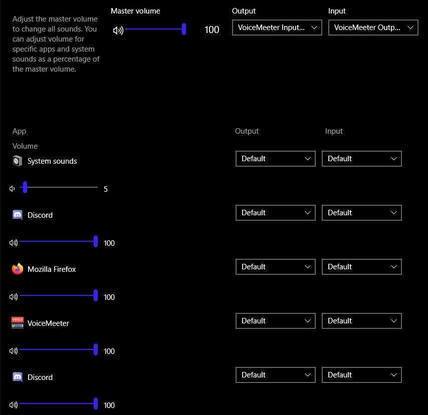

In sound manager for your VAIO devices, make sure they have the exclusive mode box unchecked. I've had issues with this before and always turn exclusive mode off for all of my audio drivers. The screen shot you are shown looks like ear trumpet. What does it look like in the Windows Audio Setting Advanced sound options App volume and device preferences?

One of the first things I did was take exclusive mode off of everything in playback and recording devices- not that I needed to with my primary system.
- Windows-Mixer.png (33.67 KiB) Viewed 20989 times
