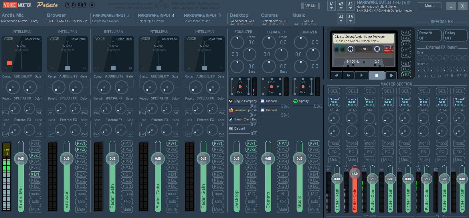

Thing is, I've had this setup before, where it is supposed to record from the specific outputs I've chosen separately. So the other problem is not a HW input messing up. It is the specifically selected output that no longer responds to "monitoring" programs, like OBS, that is designed to capture audio from the various outputs I've specified. As in, if I connect Discord to my VM AUX output, it is supposed to record that output specifically. And it did, on my former build. But now, it doesn't respond at all to it. It is connected in VM, as in I can turn down my music separately by turning down VAIO 3, but the music is not captured by programs designed to capture the audio.
In case you need a hi-res version to see it clearly:
https://u.pcloud.link/publink/show?code ... LjlFmxkqQX
(The reason why A3 is turned on for my mic, is that I used to have a separate headset connected to A3, that I recently removed.)

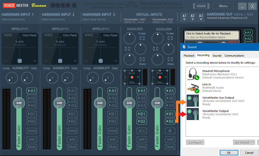

Thank you for sharing additional details. Voicemeeter Potato provides 3 virtual outputs:
  1. Voicemeeter Output: Connected to B1
  2. Voicemeeter Aux Output: Connected to B2
  3. Voicemeeter VAIO3 Output: Connected to B3
You can see them in the Recording tab of Windows Sound control panel: (I use Voicemeeter Banana so I don't have VAIO3 Output)
Voicemeeter Virtual Output devices.png (118.94 KiB) Viewed 6868 times

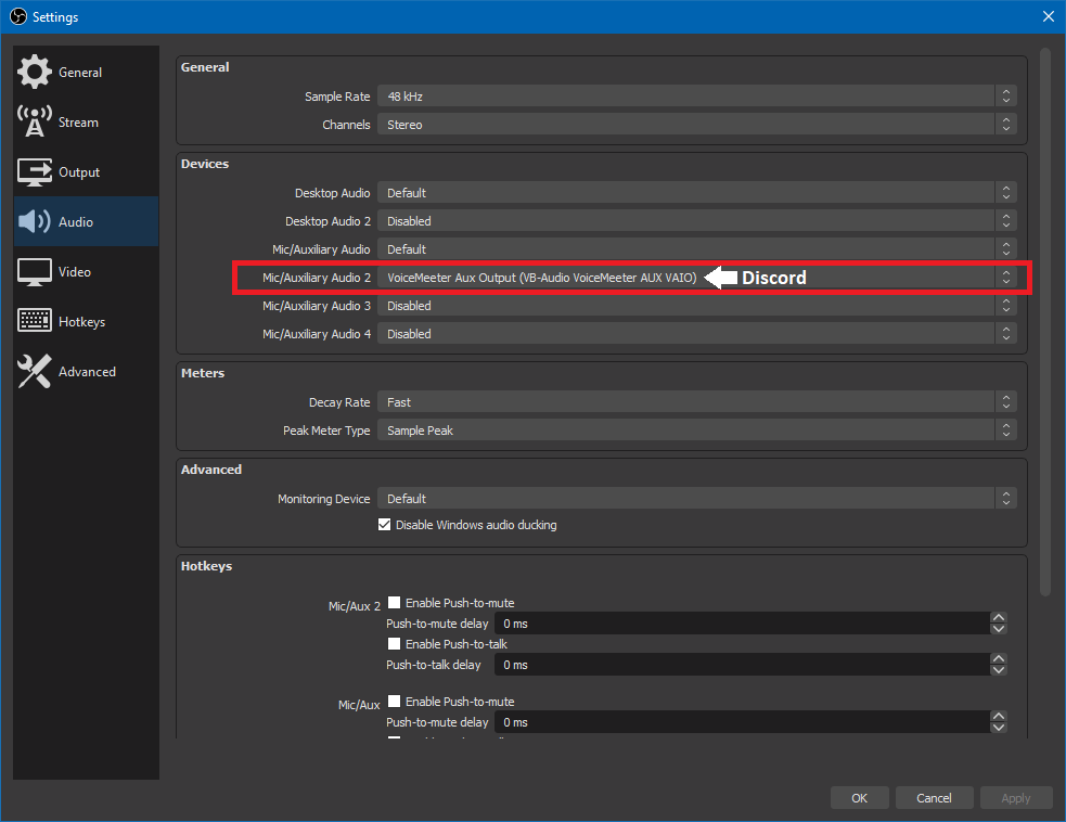

For example, If you want to Record (or Monitor) Discord in OBS, turn on B2 in the virtual input labeled Comms and then select Voicemeeter Aux Output in the Audio - Devices section of OBS Studio Settings:
OBS Audio Device Selection Voicemeeter Aux Output B2.png (41.37 KiB) Viewed 6868 times
Hope this helps.
