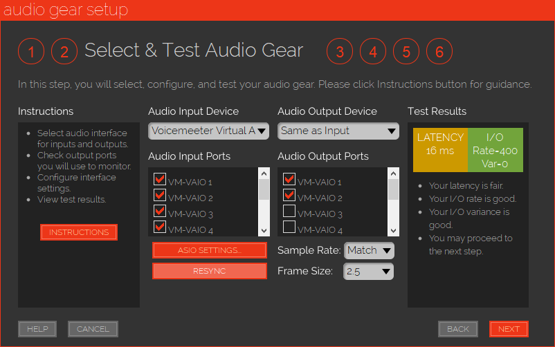

Update: I am getting improved results with the following adjustments:
  • Increased Voicemeeter Preferred Main Sample Rate option to 96000Hz: Since the device selected in A1 Hardware Output is the Main Device it sets the sampling rate used in Voicemeeter Virtual ASIO device. I selected a device that supports 96000Hz as A1 (Main Device); choose WDM option to force the use of the Preferred Main SampleRate.
  • In JamKazam Audio Gear Setup choose Voicemeeter Virtual ASIO - ASIO from the Audio Input Device list: This should start a latency and I/O test and show you results. Reported latency reduced to around 16ms

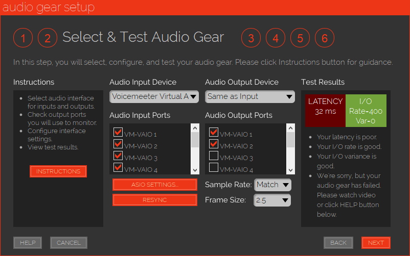

    JamKazam Audio Gear Setup - Voicemeeter Virtual ASIO 96kHz.png (40.43 KiB) Viewed 8897 times
  • Results using 48000Hz as the Preferred Main SampleRate seems to be also more stable. Reported latency is higher.
    JamKazam Audio Gear Setup - Voicemeeter Virtual ASIO 48kHz.png (42 KiB) Viewed 8901 times
Of course this is just a synthetic test; the "real" test is to be able to connect your session to Zoom and get decent audio. Please let us know what are your results using Voicemeeter Virtual ASIO devices.
