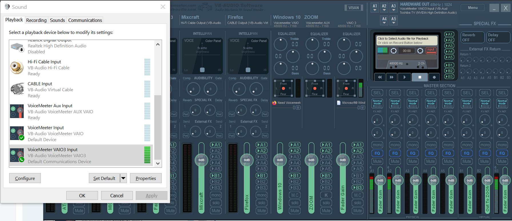

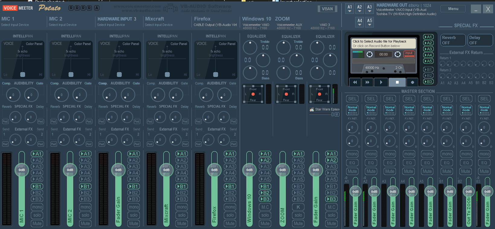

I haven't found a way to get Voicemeeter to output 5.1 sound. I'm using Potato v3.0.1.4. Realtek onboard digital output does not work any longer so I disabled it and setup 5.1 through Realtek's analog outs. In Voicemeeter output it's listed as Speakers (Realtek High Definition Audio). I configured the output in Windows as a 5.1 output. Realtek analog outs go to a 5.1 receiver. Receiver has 5.1 channel analog inputs. You can see in Voicemeeter VAIO there is only 2 channels coming through. If I go to the sound settings icon at the bottom right of Windows 10 and select Speakers (Realtek High Definition Audio) thus bypassing Voicemeeter altogether, then 5.1 is passed through to the receiver. Could someone please tell me if Voicemeeter will pass 5.1 sound and if so, how to do it with my setup.

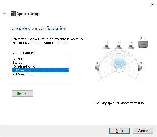

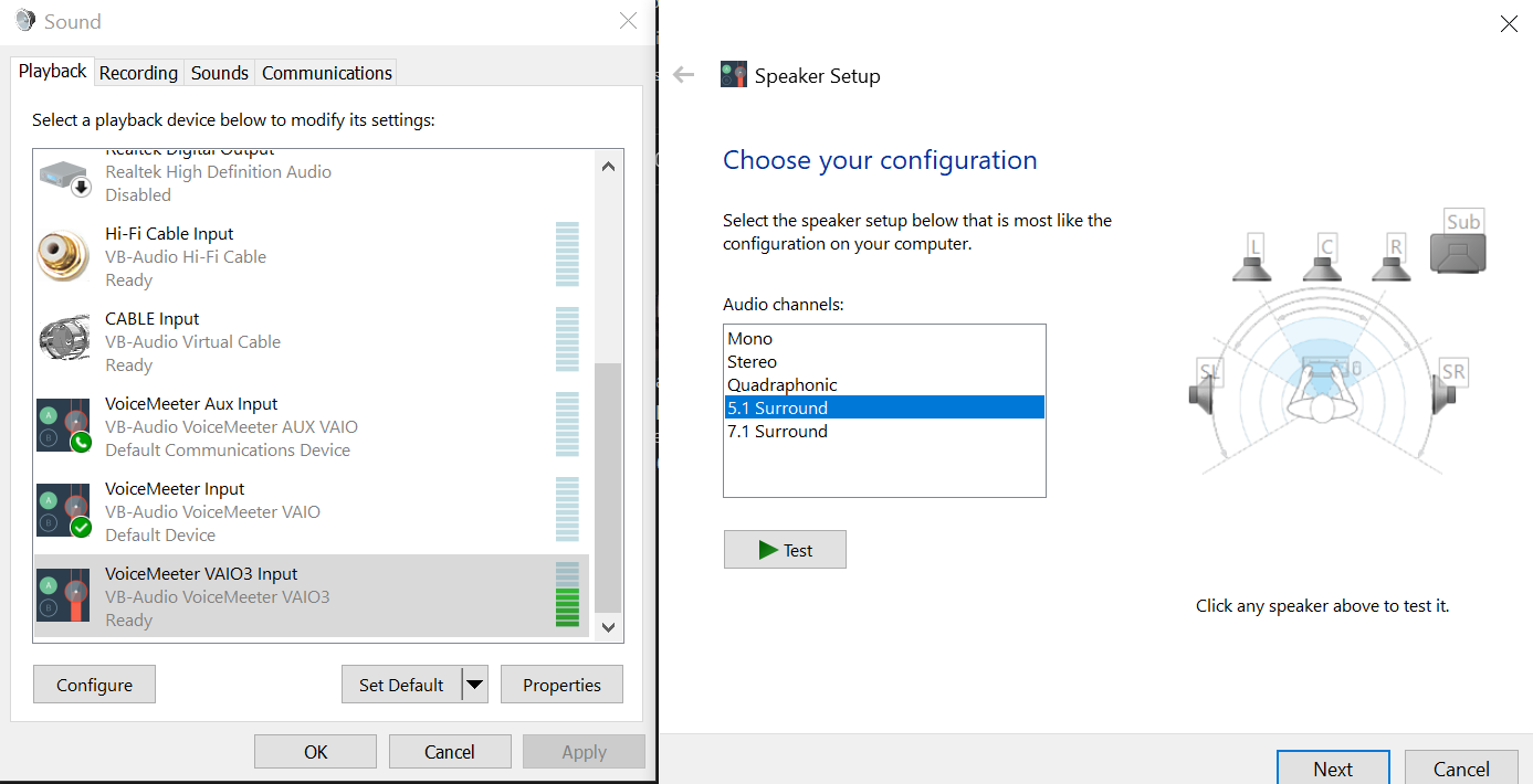

  • Go to the Sound control panel and select the Playback tab - Select the device corresponding to the desired Voicemeeter Virtual Input and press the Configure button
    Windows Sound control panel - Configure VAIO3.png (28.01 KiB) Viewed 46828 times
  • Choose the desired configuration (5.1 Surround) in the Speaker Setup window and press the ►Test button. You should hear the test sound through each of your speakers
    Speaker Setup 5.1 Surround.png (22.85 KiB) Viewed 46828 times
  • Complete the Speaker Setup process by clicking Next

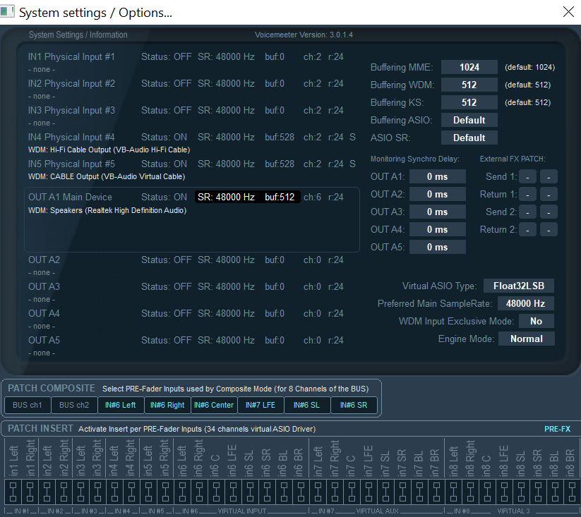

There is also a special routing mode, called Composite which allows you for example to compose a 5.1 audio signal from any combination of the channels from hardware or virtual inputs using the PATCH COMPOSITE section of the System Settings / Options... window.

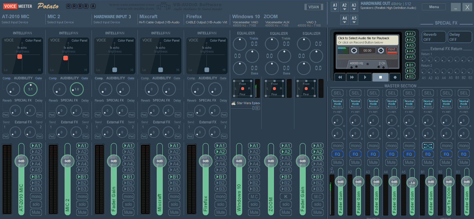

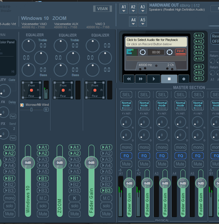

I tried your suggestions. When I run the test on VAIO 3 after 5.1 setup, I get no sound or sometimes sound through the front speakers only. Although I can see the reactions for all 6 channels on the VAIO 3 meter. I'm using Media Player Classic and when I open a file with 5.1 content, I get distorted sound and even when I close the file, the sound continues until I restart the Voicemeeter engine. What could I be missing?

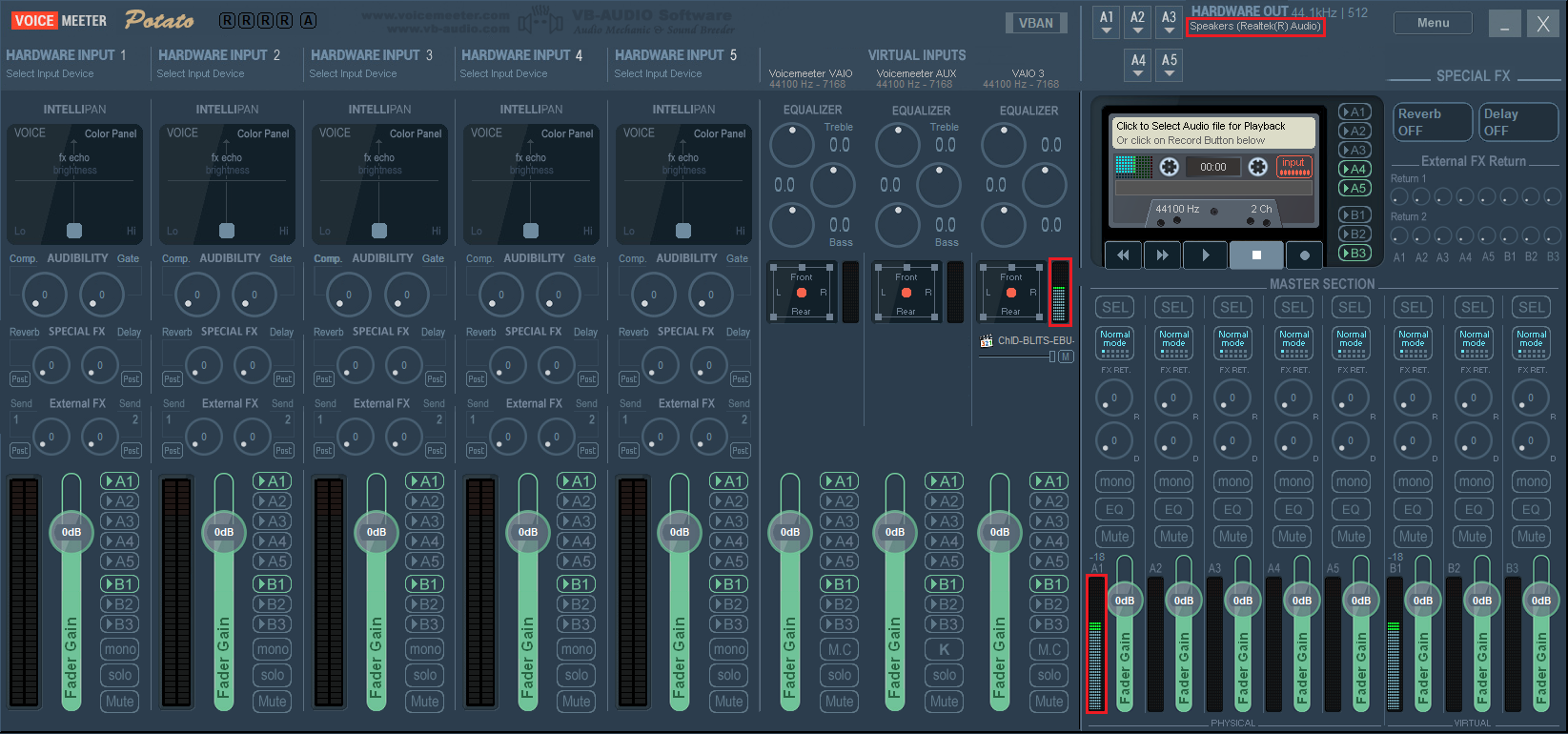

Hi. The screenshot of Voicemeeter Potato in your last post differs from the previous one in the hardware output selection. Could you please try to perform the following additional tests?
  • Make sure that the Speakers (Realtek High Definition Audio) playback device is still configured in 5.1 mode. Use Windows Sound control panel to test it.
  • Select WDM: Speakers (Realtek High Definition Audio) from A1 Hardware Out selection list.
  • Play some 5.1 content using Media Player Classic. While playing check the level meters at VAIO3 virtual input. You should see 6 bars.
  • While playing 5.1 content check the level meters at A1 hardware output. You should also see 6 bars.
I did a simple test using Media Player Classic and a sample 5.1 audio file and this is the resulting screenshot:

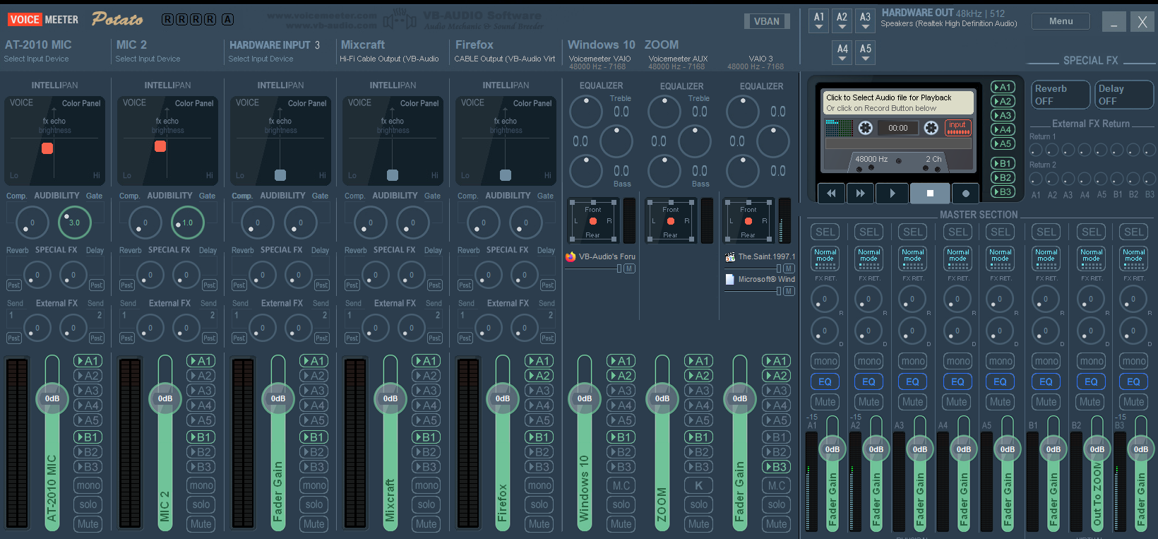

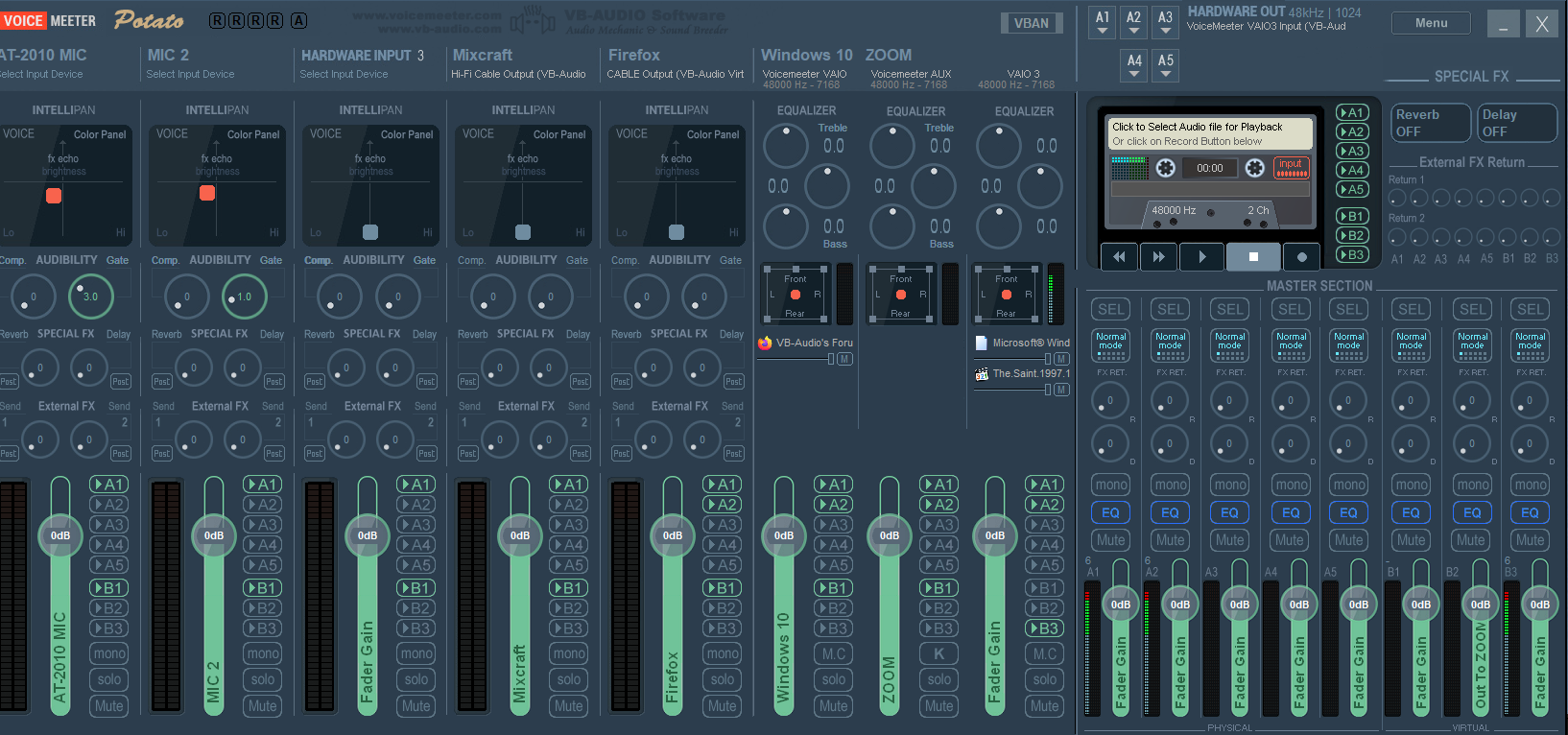

I 'm confused Andres. You asked me to assign a virtual device to output A1, so I switched it to VAIO3. So It's unclear what I should have in A1 out. When I test speakers Realtek high def audio in sound settings, I can hear all 6 channels. However when I test VAIO3 at first I wasn't hearing anything, but as I write this, it now tests OK with 6 channels. It seems finicky. I uninstalled/reinstalled Voicemeeter today in case a Windows 10 update might have corrupted something. Even when VAIO3 tests out OK with 6 channels, when I play a 6 ch files, it only plays 2 channels. With VAIO3 in output A1 I hear nothing and the meter shows 2 channels playing. When I have Speakers Realtek high def audio set to output A1 I can see and hear 2 channels playing. As I said, my DIGITAL output doesn't work any longer so I'm using the 5.1 analog output. As it seems all the 6 channel files I can find are AC3 or Dolby Digital, I wonder if that is the problem. The 5.1 analog input on my receiver may not be able to decode AC3 and spits out 2 channels as a result.

  • (In Voicemeeter) Turn on the ►A1 button in the Voicemeeter VAIO3 Virtual Input to send the audio to the A1 hardware output
So please keep the WDM: Speakers (Realtek High Definition Audio) selected from A1 Hardware Out selection list.
Since you already configured VoiceMeeter VAIO3 Input as a 5.1 device, try to test it again using Windows Sound control panel. You should hear the test sound through the 6 speakers.
