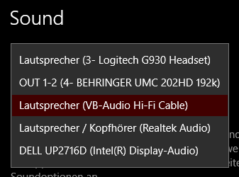

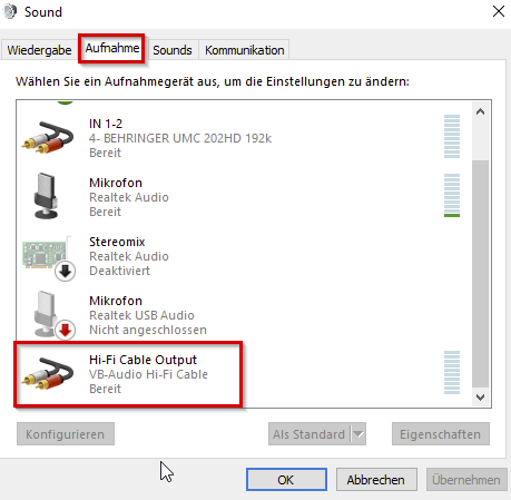

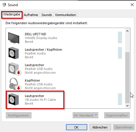

I've tried several times and also executed it as administrator and did a reboot each time. No change yet. Also I can see it in the sound settings :
screenshot 3
screenshot 3
screenshot 1
screenshot 1
screenshot 2
screenshot 2

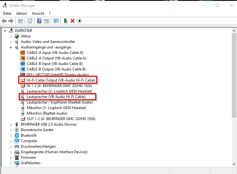

Ok so followed the recommendation from Vincent:
device manager looks like this:
2020-11-24 20_00_17-Window.png (36.9 KiB) Viewed 26975 times

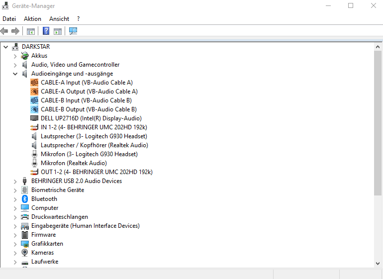

I de- installed both entries, after that, prior re- boot it looks like this:
2020-11-24 20_02_34-Window.png (32.77 KiB) Viewed 26975 times
Re- boot -> they are back, screenshot 1. A refresh after de- installation leads to the same.
I do not manage to get rid of them.

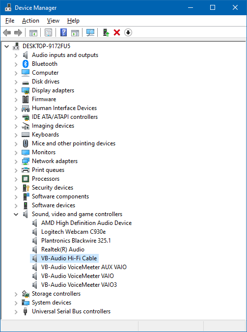

Hi Guido. In addition to the Audio inputs and outputs devices, uninstall the VB-Audio Hi-Fi Cable controller. It is located under Sound, video and game controllers. Windows should ask you to reboot your computer.
Sound, video and game controllers.png (29.83 KiB) Viewed 26968 times
