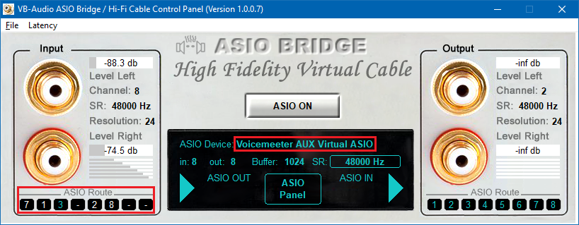

Hi. I am not sure if there is a way to do that using only Voicemeeter. Since you are planning to use this setup with games, latency should be minimal and this alternative could increase it:
  • This requires at least Voicemeeter Banana; A1 Hardware Output will be used for SL and L. A2: Center and A3: R and SR
  • Install Hi-Fi Cable. It adds a Virtual Audio playback device called Hi-Fi Cable Input. Reboot your computer after installing it. Warning: Installing a new audio device can change your previously selected default playback device.
  • Go to Windows Sound control panel - Playback tab. Right click on Hi-Fi Cable Input and select Configure Speakers. Choose the 7.1 option.
  • Open ASIO Bridge: It is located under the VB-Audio programs folder. Just go to Start and type ASIO Bridge
  • Click on Select A.S.I.O. Device and select Voicemeeter AUX Virtual ASIO. This corresponds to the Voicemeeter AUX virtual input.
  • Route the required 5 input channels to your desired location. See this for reference:
    ASIO Bridge Input Routing.png (194.82 KiB) Viewed 5103 times

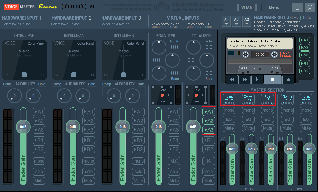

  • [In Voicemeeter] Route the Voicemeeter AUX virtual input using the ►A1, ►A2 and ►A3 buttons
  • [In Voicemeeter] Change the routing mode of A2 to Center only and A3 to Rear only
    Voicemeeter Master Section.png (120.47 KiB) Viewed 5103 times

The ASIO Bridge output only has 2 channels and only the inputs directed to 1 & 2 pass sound through.
Do I need 3 ASIO Bridges or a way to configure the output device to handle 8 channels?
