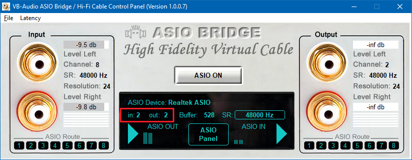

Hi. How many Inputs and Outputs does ASIO Bridge show you when you select your K-Mix as ASIO device?
ASIO Bridge.png (185.4 KiB) Viewed 44805 times
You can check all the output channels of your ASIO driver using ASIO Driver Tester: viewtopic.php?p=4259&sid=7748915fc7b3d1 ... ea3f#p4259
Go to ASIO Device menu and select your ASIO device. By default it generates a Sinus wave at 440Hz that is sent to all output channels.

@andres I can't see how to paste an image here but i do get the expected 8 channels showing
The tester does produce noise on all 8 channels and showed my I had accidently muted 3 & 4 in the mixer - D'oh. PC sound out on 3 & 4 works perfectly. Whoop!
FYI 10% callback error just keeps incrementing

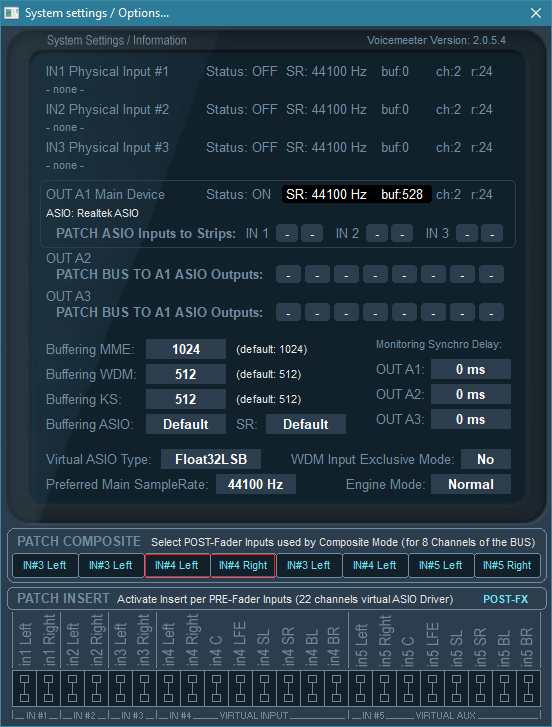

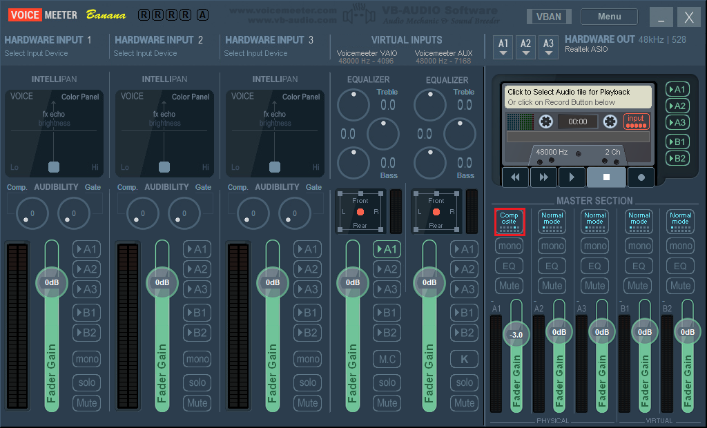

Hi. You could try to set this up using Voicemeeter Banana (Potato also supports this):
  • Select the ASIO option for your K-Mix from A1 Hardware Out selection list.
  • Set the Windows Default Output device to Voicemeter Input (VB-Audio VoiceMeeter VAIO). Use for example the Speaker icon in the notification area.
  • Route the Voicemeeter VAIO virtual input to the K-Mix using the ►A1 button
  • Change the routing mode to Composite for the A1 bus under MASTER SECTION
  • Open Voicemeeter System Settings / Options... window.
  • Under PATCH COMPOSITE section, select IN#4 Left and IN#4 Right in the third and fourth box respectively. Select an unused channel for the others.
Voicemeeter Banana A1 Composite ASIO output.png (117.93 KiB) Viewed 44747 times
PATCH COMPOSITE.png (70.67 KiB) Viewed 44744 times
Please let us know if this could be an option for you and if you need further assistance.
