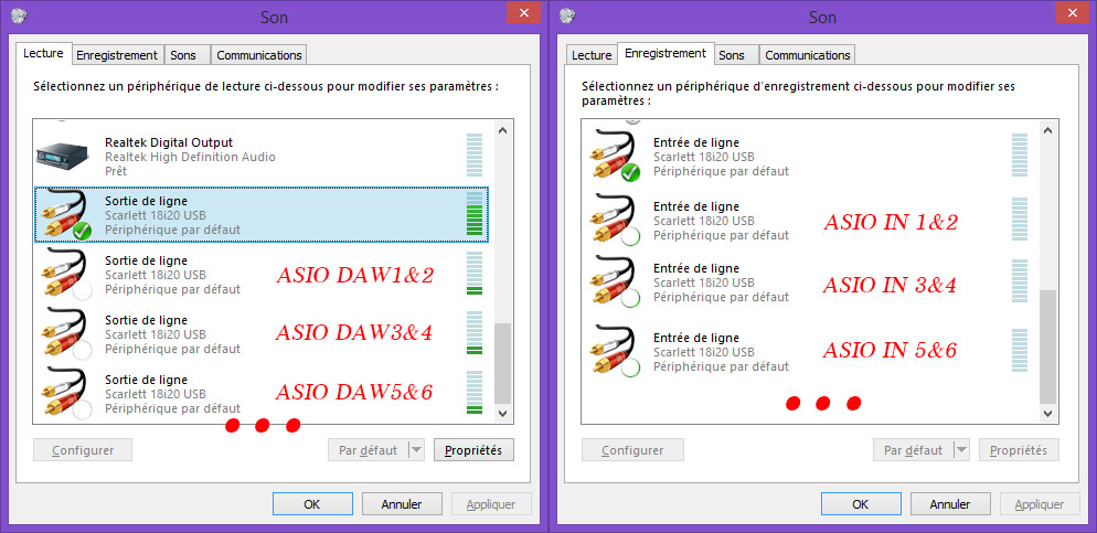

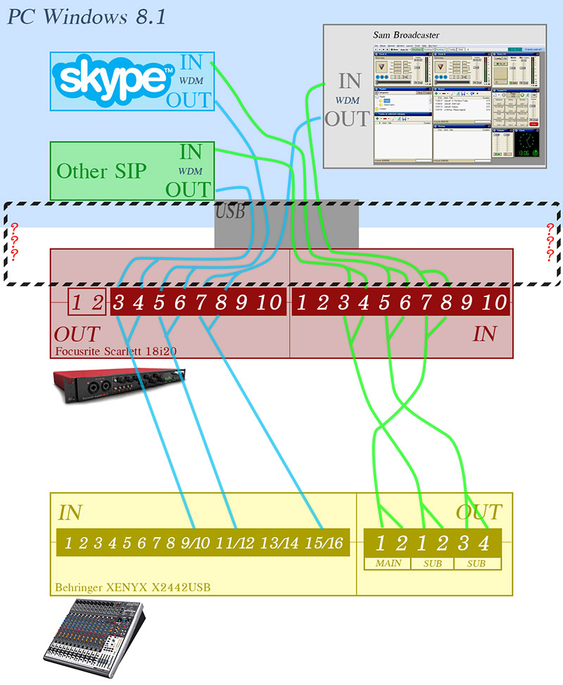

I am trying to route the sound of my sound card in... windows...
I will join a diagram of what I like to do. There has been there a way to get by with VoiceMeter ?
Routing desired
Routing desired
Again attached , there is a program to create this kind of route to the ASIO ?
A program for this?
A program for this?

for this kind of routing , first you need to use Voicemeeter BANANA
1- you connect your output A1 to your Focusrite ASIO driver.
Voicemeeter will allow routing first 8 i/o (i guess it's enough for what you want to do do).
2- route your Focusrite input to Voicemeeter Physical input by the ASIO Patch (in the system settings dialog box).
according your schema, you will route IN#1 to ASIO channel 2,3 / IN#2 to ASIO channel 4,5 / IN#3 to ASIO channel 6,7
3- connect your Skype and SAM to virtual I/O of Voicemeeter Banana (exemple Skype on Voicemeeter I/O and SAM on Voicemeeter AUX).
and assign your physical input to desired BUS B1 or and B2 to send audio to Skype/SAM
4- USE the COMPOISTE mode BUS A1 to send a given Voicemeeter Input to focusrite output (PATCH COMPOSITE is also in the system settings dialog box).
Hope it helps...
