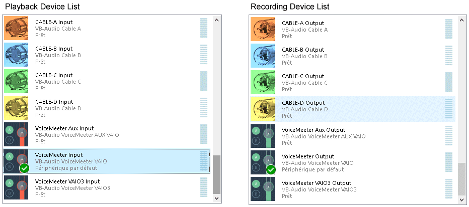

Anyway your VB-CABLE or Voicemeeter VAIO's must appear like on the picture below for Playback and Recording Devices. Otherwise you should re-install them correctly.
- VBAudioDeviceList.gif (37.2 KiB) Viewed 8530 times
