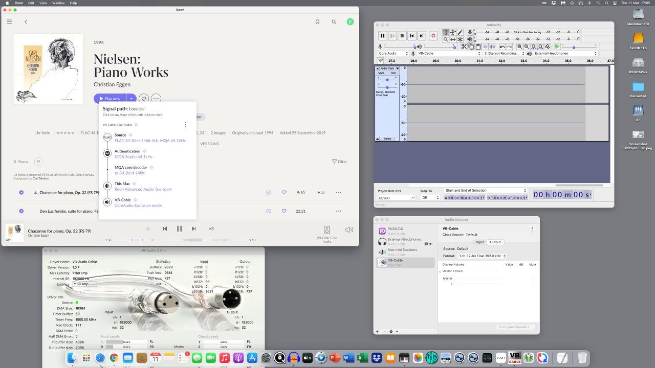

I have a 2018 MacMini running Big Sur 11.3.2. I have installed the most recent version of VB-Cable. The Control Panel of VB-Cable opens up correctly.
I would like play back an MQA file (which I purchased) with Roon and then record the unfolded MQA file with Audacity.
I set up all the programs to 88.2kHz, as that is the playback sample rate of the MQA file in question. This is a screenshot of the settings:
As soon as I start playback on Roon, VB Cable switches to 192kHz. Audacity on record does not receive anything.
I have used VB-Cable to do this very same thing on my Windows 10 machine, but I got dropouts. That is why I would like to try with my MacMini.

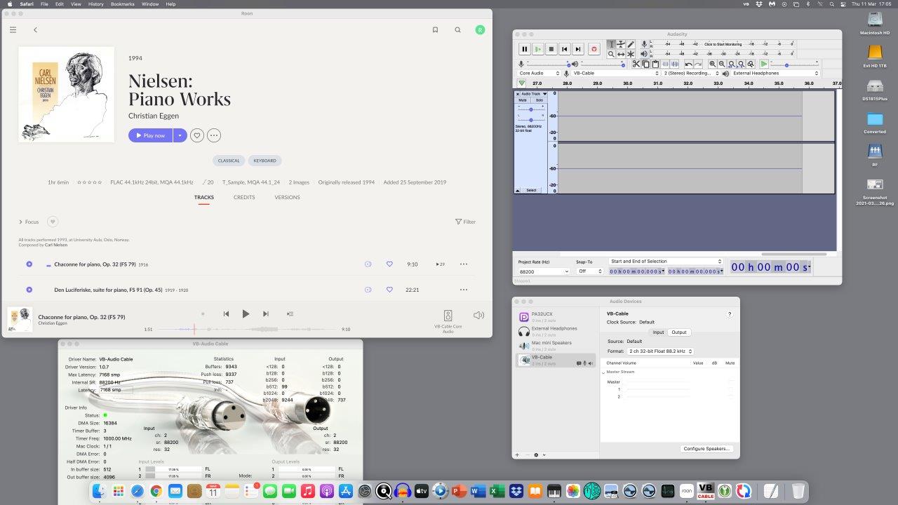

The top screenshot shows the configuration BEFORE Roon starts to play. VB-Cable is set to 88.2kHz both on input and output.
As soon as I press play in Roon (and Roon actually starts playing at 88.2kHz), VB-Cable switches to 192kHz both on input and output. This is shown in the second screenshot. And yes, I have clicked on record.

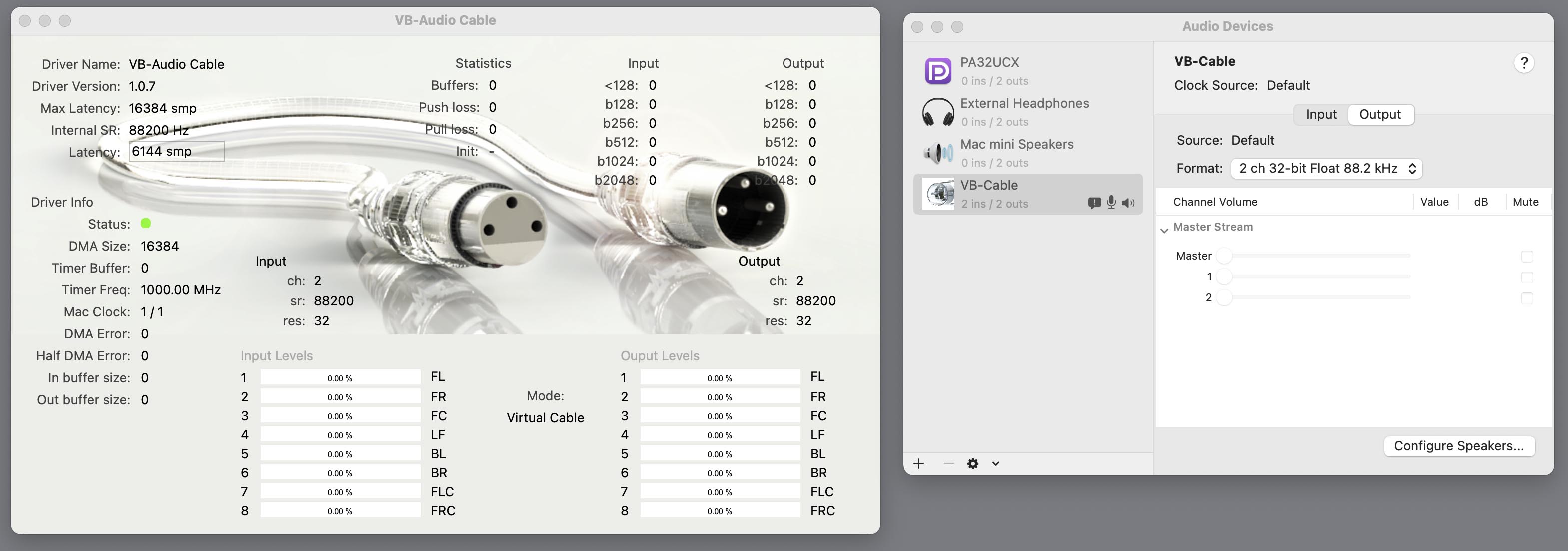

Sorry that my screenshots before were not clear. I had to reduce the size and probably overdid it a bit.
I have now added three jpg's that should be readable.
The first one shows the settings of VB-Cable Control Panel when adjusted do 88.2kHz through Audio MIDI Setup. VB-Cable is set to 88.2kHz, as playback of Roon will be at 88.2

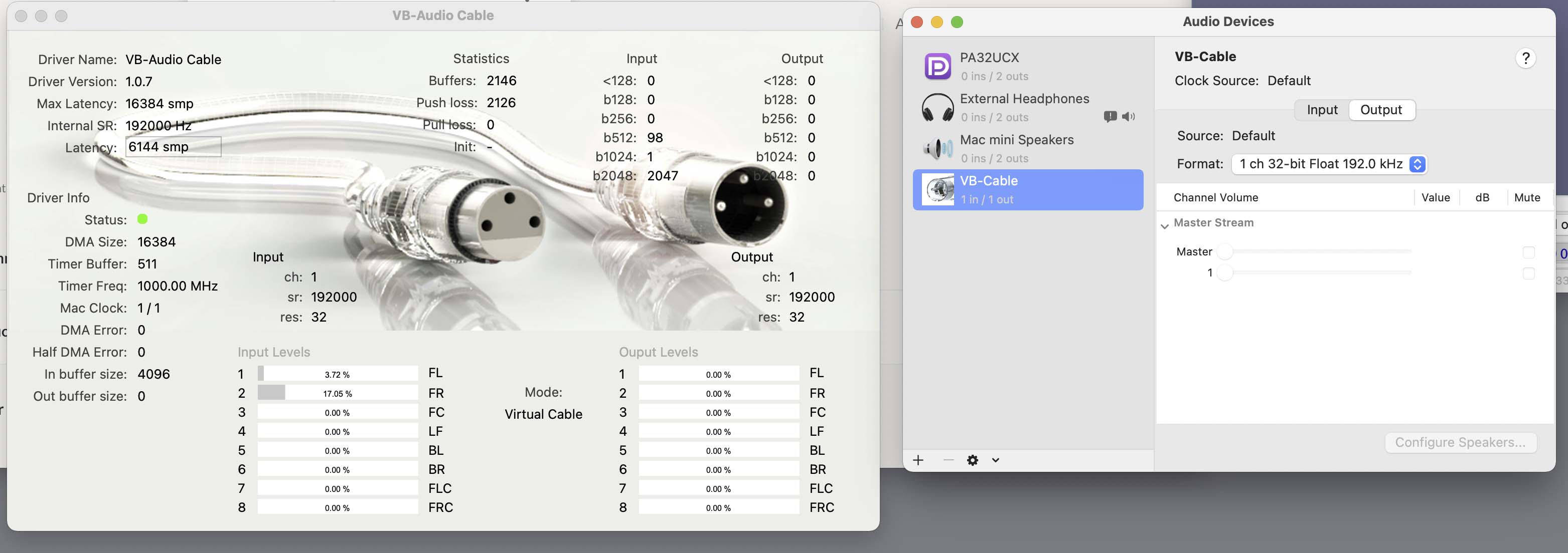

The third one shows the VB-Cable Control Panel after Roon playback has started (at 24/88.2kHz). At the instant playback starts, VB-Cable Control Panel changes from 2 Channel 88.2kHz to 1 Channel (!) 192kHz.

- Posts: 2225
Re: VB-Cable on Big Sur?
Well, the cable is made to connect 2x applications together (a player to a recorder).
so on the first ControlPanel, i see only one application connected to: the player is sending audio with 4096 sample buffer size.
ok but you have no capture application connected to the output of the cable...
jacobacci
- Posts: 9
- Joined: Sat Feb 20, 2021 7:04 pm
I had connected VB-Cable to Audacity at the other end. I have now found out that Audacity was set to 1ch (mono) instead of stereo. That seemed to throw VB-Cable off course.
I have now set Audacity to stereo and everything works fine.
Sorry for the trouble.
