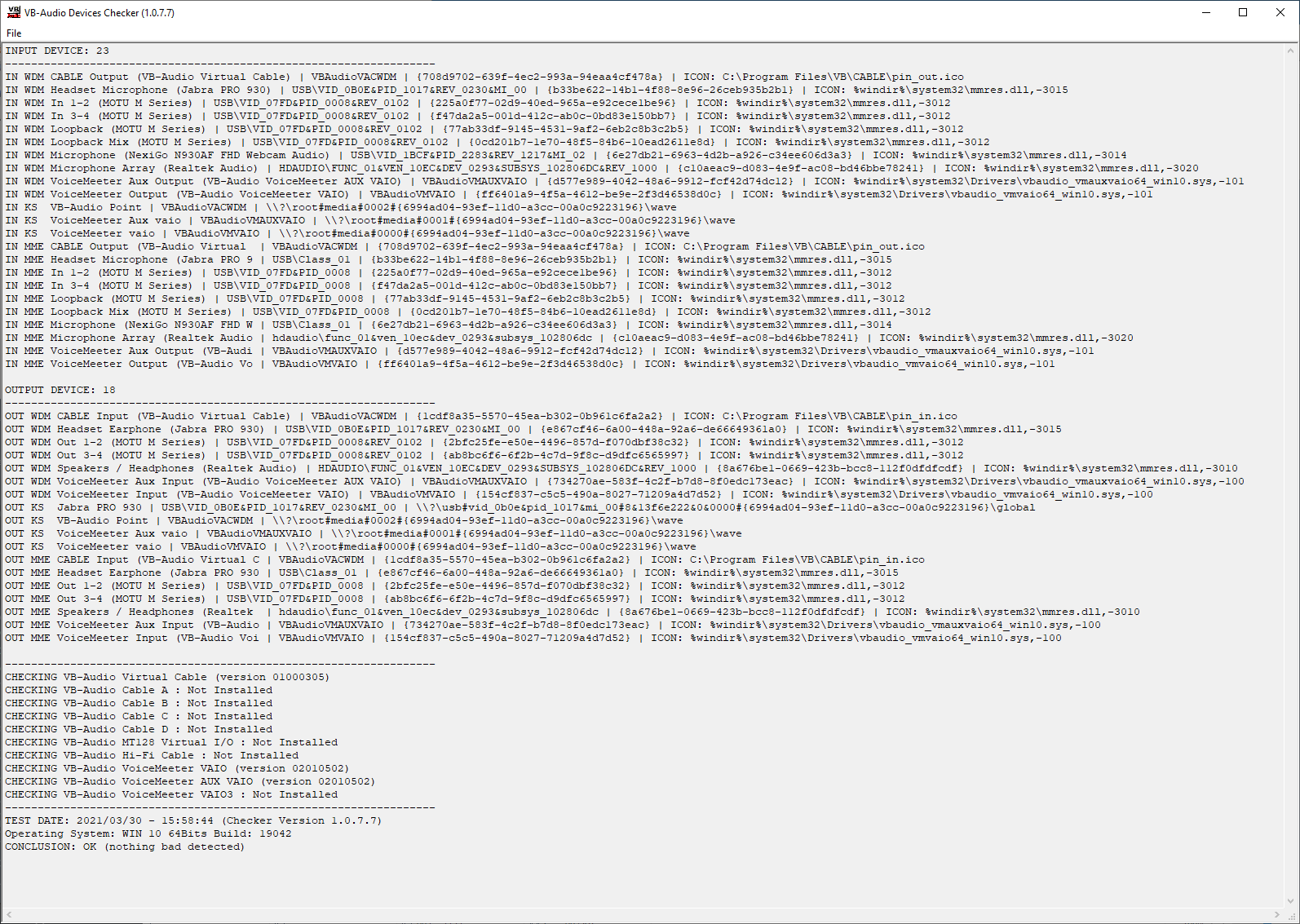

When I run Check driver installation, the camera shows up in the list of 23 input devices and reports:
TEST DATE: 2021/03/30 - 00:53:43 (Checker Version 1.0.7.7)
Operating System: WIN 10 64Bits Build: 19042
CONCLUSION: OK (nothing bad detected)
It seems that voicemeeter takes exclusive control of the camera even though it's not selected for input or output.

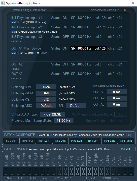

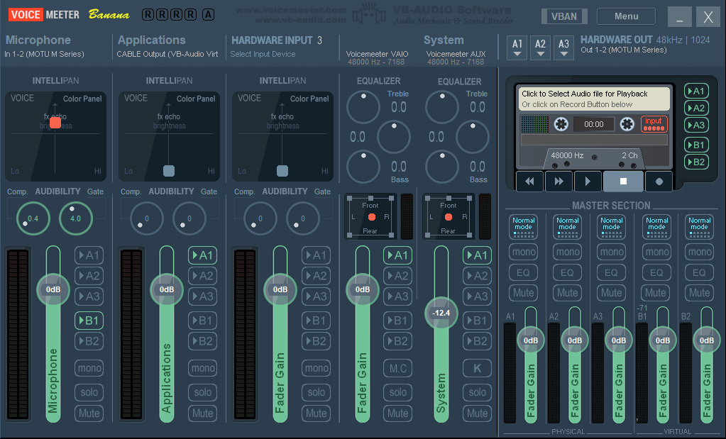

could you please post a screenshot of Voicemeeter and it's system settings dialog box (in Menu).
mpm126
- Joined: Mon Mar 29, 2021 5:12 pm
Re: Voicemeeter locks my camera
When I first installed voicemeeter I didn't have this trouble.
I'm not sure what changed, but I think I received a windows update and I switched audio interface from scarlett solo to Motu M4.
But I didn't notice the camera trouble for a while, so I don't know what change caused it.
- vm_settings.png (90.57 KiB) Viewed 16872 times
- vm_screen.png (124.79 KiB) Viewed 16872 times
- vm_devices.png (203.64 KiB) Viewed 16872 times

well, accordign your settings, Voicemeeter does not use your camera.
and by using MME device, you are sure to get no conflict with other applciations willing to use the same device.
so, i've no explanation about your problem...
