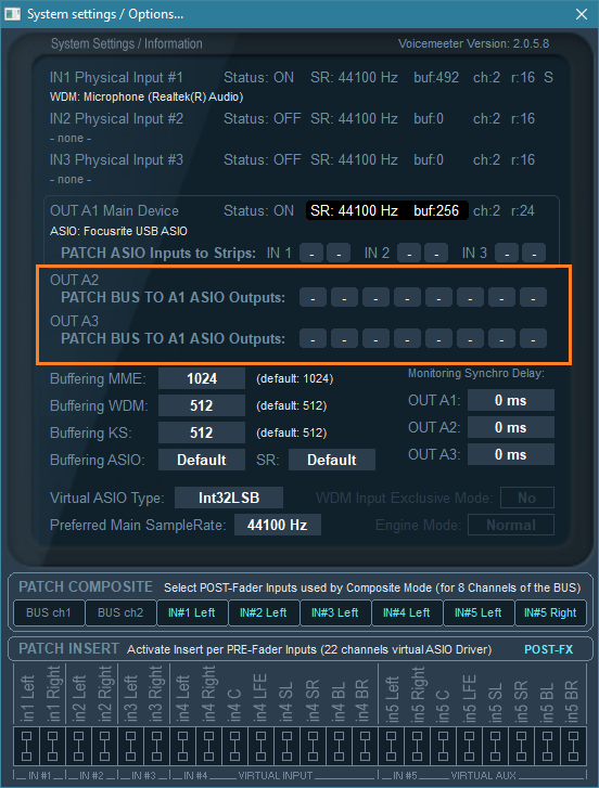

Hi. Since you are using ASIO for A1 you could try to use PATCH BUS TO A1 ASIO Outputs instead of using WDM or MME at Hardware Out A2, A3 etc.
Just select - remove device selection - from A2, A3 and so on and enable the PATCH.
PATCH BUS TO A1 ASIO Outputs.png (72.44 KiB) Viewed 7607 times
