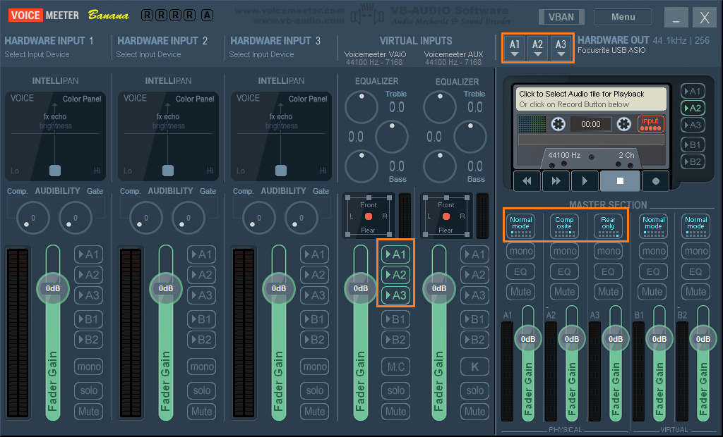

Hi. Not really sure to understand your scenario since I don't use DVS (Dante Virtual Soundcard). You could explore this setup using Voicemeeter Banana:
  • In Windows Sound Control Panel - Playback tab - VoiceMeeter Input - Configure button - Set Speaker Setup to 5.1 Surround. This is where the game audio enters Voicemeeter
  • Select DVS Transmit 1-2 at Hardware Out A1 (Left and Right Surround Channels)
  • Select DVS Transmit 3-4 at Hardware Out A2 (Center and LFE channels
  • Select DVS Transmit 5-6 at Hardware Out A3 (Rear Left and Rear Right)
  • Turn on A1, A2 and A3 at Virtual Input VoiceMeeter VAIO
  • In the MASTER SECTION select Normal for A1, Composite for A2 and Rear Only for A3
  • Open Menu - System Settings / Options... and set PATCH COMPOSITE this way (only 2 first channels are relevant):
    PATCH COMPOSITE Center - LFE.png (1.27 KiB) Viewed 11917 times
  • Your setup should look similar to this:(I have not selected A2 or A3):
    VoiceMeeter 5.1 VAIO to 3 stereo pairs.png (126.79 KiB) Viewed 11916 times
Hope this helps. Let us know if you need any clarification since this setup is pretty particular.

Andres, you are a genius, this works! I was looking at the routing capabilities of this program in a completely incorrect way it seems.
Thank you very much.
The only seemingly unfortunate byproduct of this method is differing amounts of latency between the sets of channels; it is noticeable in material that plays in the front and rear channels simultaneously.
