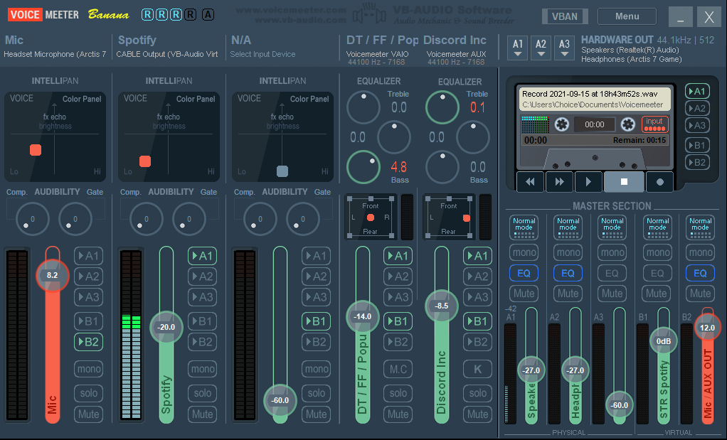

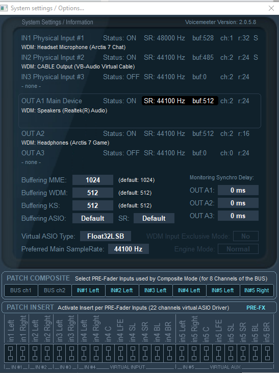

My virtual audio cable strip (Spotify) is stuttering/staticy etc on about half of Windows startups. WDM is unusably choppy+ "blown out," while MME is sometimes better, sometimes much worse. Everything else--desktop audio, Youtube, etc--is fine.
I tried recording/playing back A1 (my speakers) to test it as mentioned in the pinned thread, and while there's choppiness there, it's not exactly as it was when I was recording it.
Here's a picture of my setup.
Any help would be much appreciated, it's really driving me crazy.

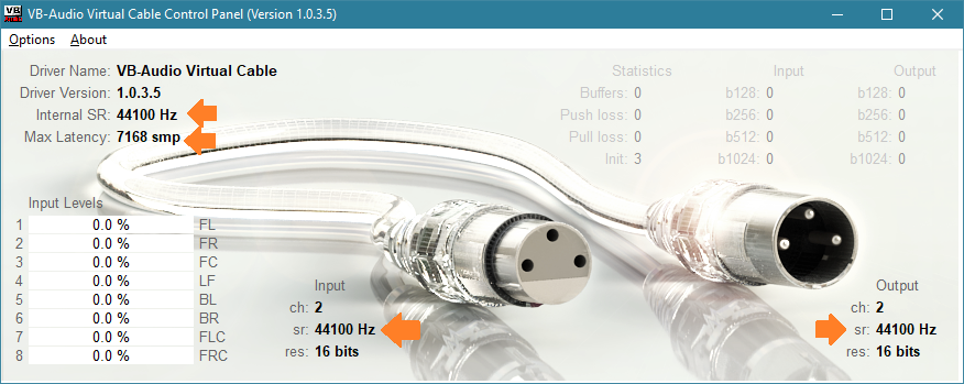

  • Open this folder C:\Program Files\VB\CABLE and run the control panel app: VBCABLE_ControlPanel.exe. Set Internal SR to 44100 Hz. Check also Max Latency value; it should be in 7168 samples. Restart Windows if necessary. It should look similar to this
    VB-CABLE Control Panel Settings.png (247.8 KiB) Viewed 22319 times

I actually had everything set to 24-bit 44100 already, but double checked them. Internal SR was 44100, Max Latency 7168. Fwiw, unlike your image, res is 24 rather than 16 bits (image attached).
