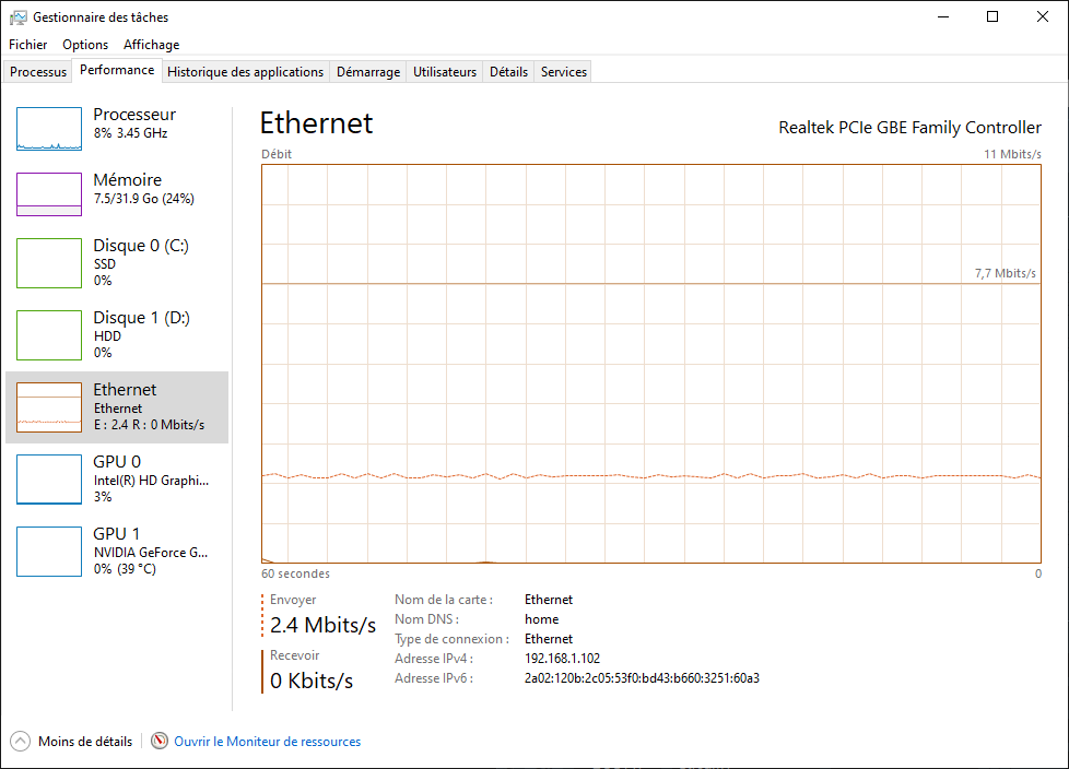

The two following screens are from the laptop with only VBAN turned on, everything appears normal. No video streams are playing in Opera.
After some testing, the network activity of VoiceMeeter remains at this constant (as it should as far as I know) even if an audio only stream is opened in the browser or if a local .mkv video file is played as I've described in the first post.

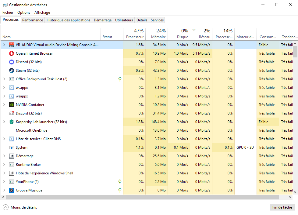

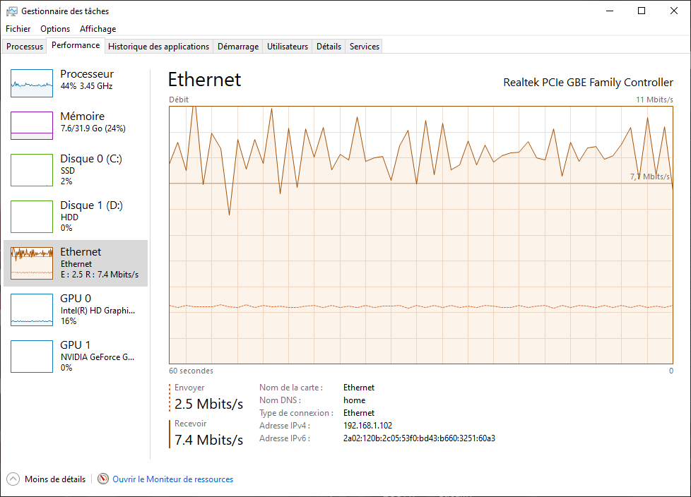

The next two screens were taken when a video stream was being played in Opera on the laptop. The first highlights the issue, VoiceMeeter appears to go... well, bananas (pun intended sorry :lol: ). I've seen it peak as high as 30 Mbits/s earlier this week.

The second is even more confusing as it only shows normal download/upload activity with video stream open in this tab. But I know something is wrong as in this state, it even affects the "ping" of the desktop to the network/internet but was unable to see anything unusual in the desktop's Task Manager, only recieving a stable 2.3 Mbits/s.
