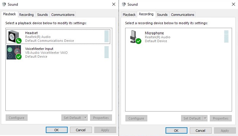

Current Setup
Onboard sound card (Realtek) and Headset w/ mic.
As seen in the attached pictures along with Voicemeeter settings.
  • Up until now i was using Voicemeeter Standard in order to separate my PC main audio from the communication audio with just my on board sound card (Realtek). so when i stream the communication audio won't get captured. Pretty basic.

WindowsSoundControlMicandOutput

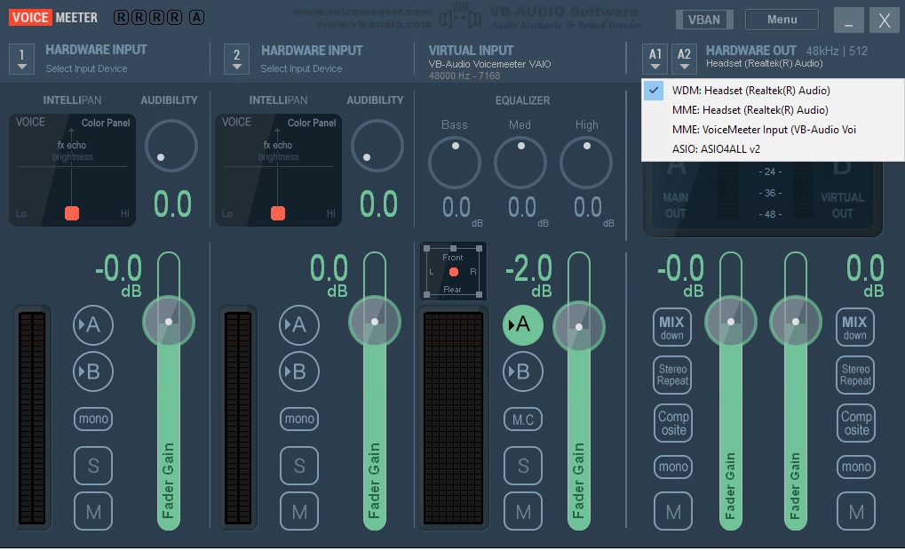

CurrentVoicemeeterSetup

From what i gather, i think Voicemeeter might not work? The external USB audio interface is going to use ASIO but the internal Realtek card WDM.
Would this cause conflicts between the two interfaces when i'll try to route the PC audio to both?
Also now with just the Realtek the windows volume is set at 100% and Voicemeeter acts as a pre.
With MOTU what would be the case? Should MOTU's volume be set at max as well and let Voicemeeter handle the volume levels?
Re: Help with USB Audio Interface - Onboard soundcard Setup
ElectricEye wrote: Tue Nov 30, 2021 8:57 am Would this cause conflicts between the two interfaces when i'll try to route the PC audio to both?
Voicemeeter is designed to work with different interfaces (ASIO, WDM, KS or MME) for your hardware input and output devices. You can mix them and it should work without any issue.
