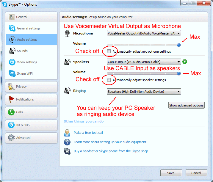

Only one little problem remains now:
everything seems to be fine apart from one thing, which is that the Skype caller (In this case the woman on Skype test service/Echo) sounds very weak.
Maybe a setting in Skype, where I have set the Mic (which sounds fine) to Voicemeeter Output and the speakers to Voicemeeter Input.
Just to Recap, In Voicemeeter, I have A1 set to Realtek Speakers.
Strangely enough, when I run Skype on my system, without putting it online, it sounds fine, but when going online, the caller is almost inaudible.
Am I still missing something?
Thank you for all your help so far.
Posts: 2214
Re: Live interviews with Skype and Mixxx via Banana

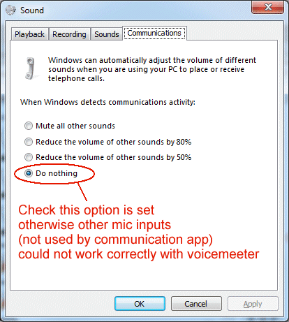

ok, the loop was done by connected application (we used to make a warning on monitoring option for ASIO DAW connected to Voicemeeter, i should have think about this with Mixxx).
Anyway, for your Skype level, check your Skype Audio Configuration:
check also your Communication options:
