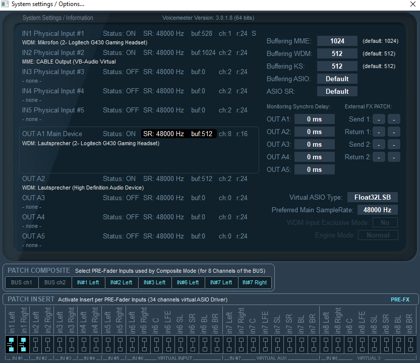

EDIT: I replaced the first screenshot of voicemeeter settings because I didnt set it back to the default I had it all the time. Hardware Input 2 was empty but there I have "Cable Output WDM" activated to use it for my Firefox Audio. Seems like that this combination makes the most crackling sounds while listening to videos on youtube or so.

you may first consider installing latest version
if the problem remains, please post a screenshot of Voicemeeter and it's system settings dialog box (only 2 screenhsot).
then describe the audio path where you get crackling like
Youtube -> Voicemeeter Virtual Input -> Voicemeeter Output A1

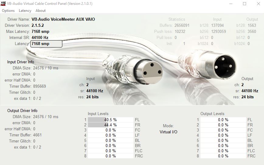

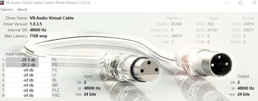

if the problem remains, please, post a readable screenshotof the VBCABLEControlPanel when sound is passing thrue...

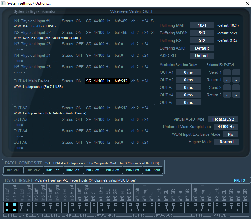

sadly I have to return my "ok". =/
It does not happen often but there are some "hanging moments" again over "Voicemeeter AUX". They are rare but they exist. (Maybe every 10-30 Minutes?).
I've set everything back to 44.1khz. So dont wonder that this is changed. Its the same configuration like in the other screenshots but only set everything to 44.1khz.
