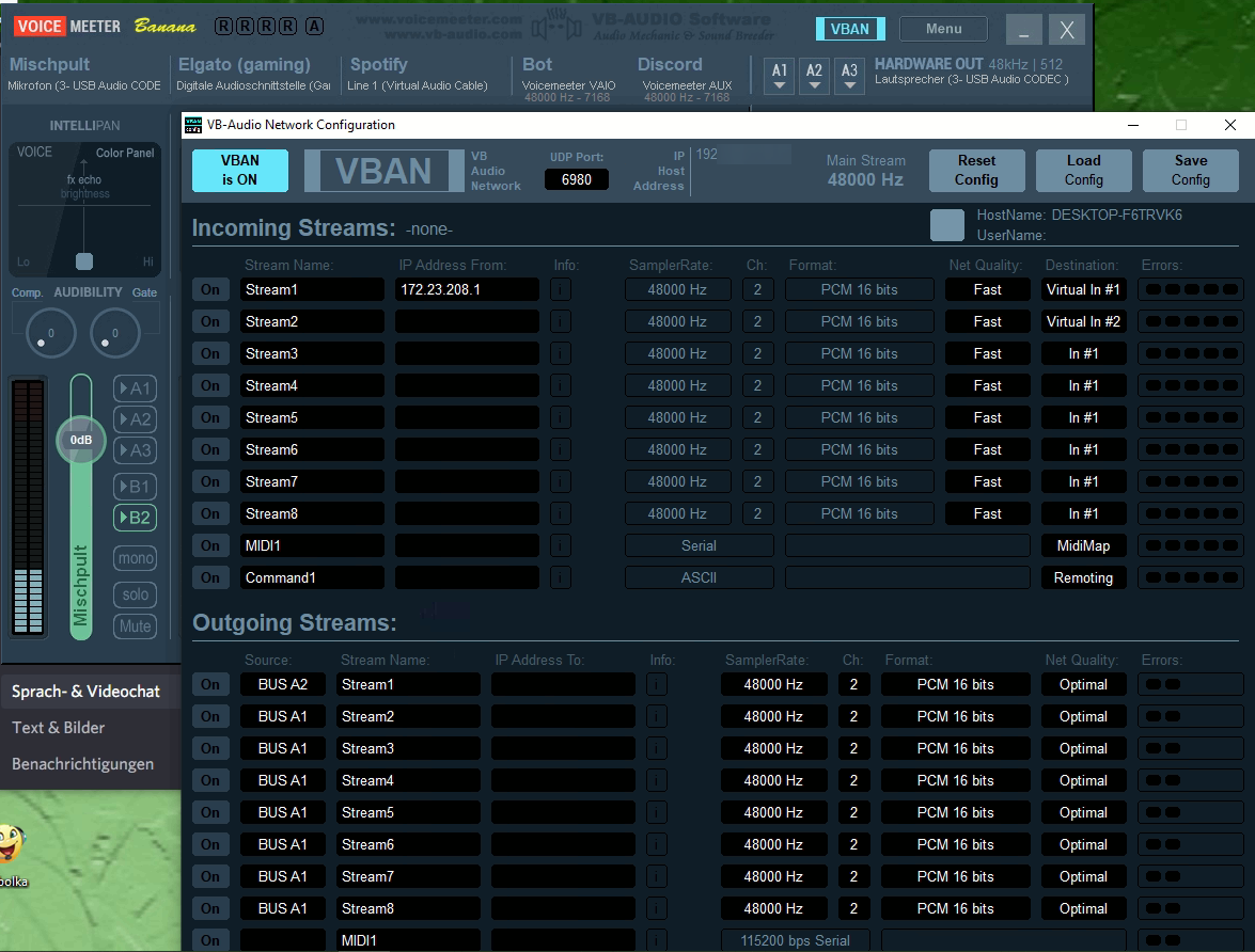

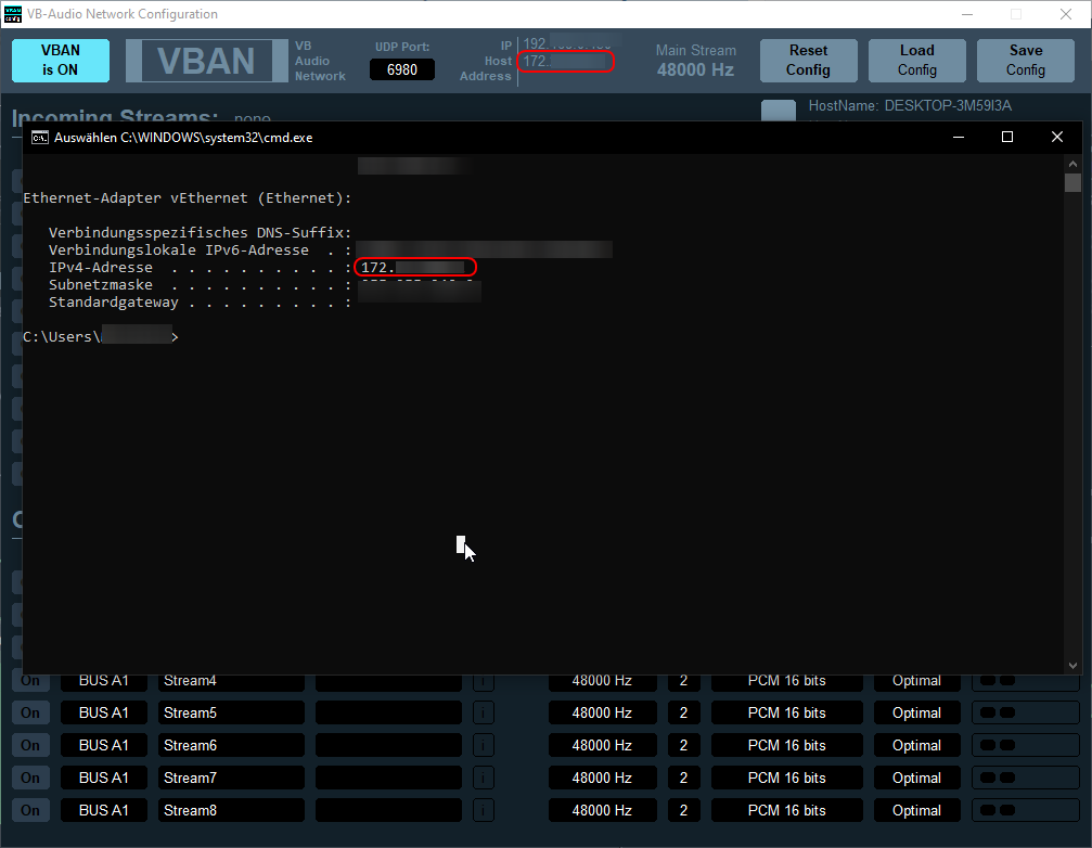

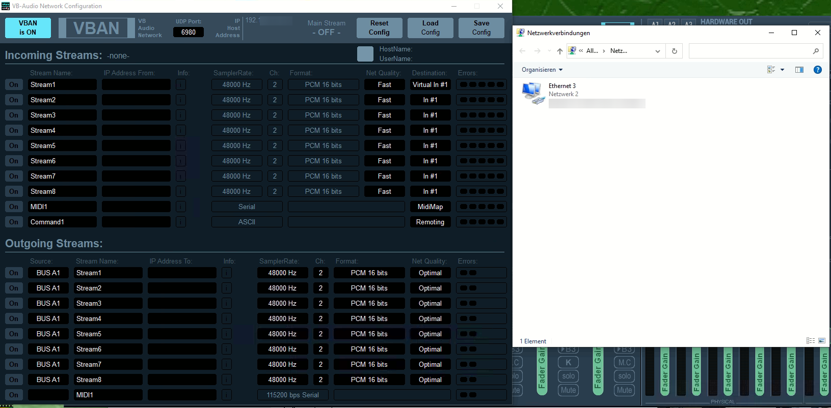

We installed Voicemeeter on his PC and started VBAN. In difference to my VBAN, there is no IP in "Host". Only in "IP"
On my program, there is an IP in "Host".
and the IP is the same as the network-Adapter "vEthernet"
And on my friends computer there is no secound network-Adapter or the question to let the program pass the firewall... (like this Yes/No prompt)

on your first PC, the Main Stream is OFF
it means you have not selected an output Device for Output A1
so there is no master stream, so nothing works.
