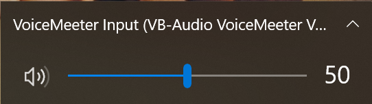

When Windows is resumed from hibernation while VoiceMeeter runs the system volume is increased by 2 percent. This issue is reproducible.
A fix would be highly appreciated.

Horned_Reaper
- Posts: 8
- Joined: Fri Sep 04, 2020 9:19 pm
Re: System volume is increased on resuming Windows from hibernation
Hello Sam,
thanks for your support, really appreciated.
Yes, the Windows Volume Mixer is one way to see the system volume level.
I use Windows 10 21H1, inlcuding the latest updates and Voicemeeter 1.0.7.8.
The issue is very easy to reproduce:
1. Check the system volume level e. g. 50 % (see attached screenshot).
2. Put Windows to Standby or Hibernate mode.
3. Resume Windows from Standby or Hibernate mode.
4. Check the system volume level. It is increased by 2 % e. g. 52 % (see attached screenshot).
I'm looking forward to your debug results.
Cheers
Manuel

Horned_Reaper
- Posts: 8
are there any findings to this issue?
Thank you and best regards
Manuel

Horned_Reaper
- Posts: 8
Thanks for your reply.
That's strange.
There must be a relationship between Windows and the VoiceMeeter input audio device. I don't face this issue without Voicemeeter installed.
Can you reproduce this issue on your end?
