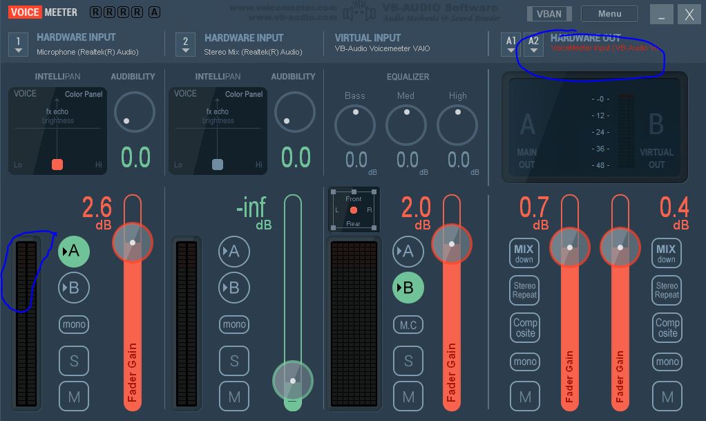

Today my Win 10 system froze and crashed and on reboot, VM does not work. There was NO AUDIO MIC SIGNAL in Hardware Input 1, although the correct active mic was selected. VM "looks OK" except in the upper right, Voicemeter Input is BLINKING RED (I uploaded jpeg). Although the screen looks OK, no sound is passing through. I have looked at WIndows Sounds and it "looks ok" but I'm not sure what I'm looking for. Under Sounds/Playback/VM INPUT, Jack Information says No Jack, but I have no idea what that means or if it requires or allows an action by me.

- VM FAIL.JPG (88.29 KiB) Viewed 7321 times
