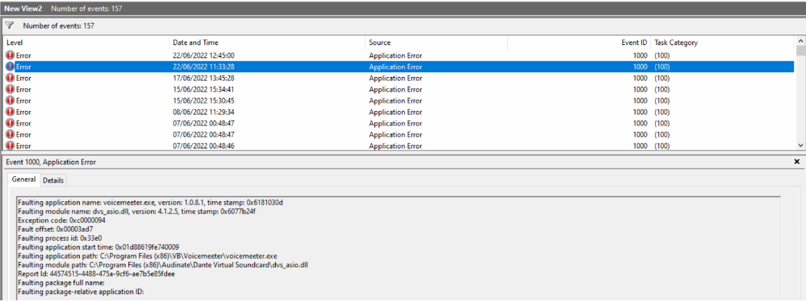

Hi team,
Just trying to get to the bottom of an issue where Voicemeeter is crashing and DVS is set as the output device. Attaching event viewer report here. Crash frequency appears to be about once a week. I figure it's possible that the issue is with DVS software but the soundcard itself is still reachable by other devices following the crash. Has anyone experienced similar before?

- WindowsLog.png (250.46 KiB) Viewed 6792 times

hello,
Assuming you are running the latest Voicemeeter version ? could you precise what you mean by "crash",
1- Sound is stopped but you can restart audio engine,
2- Voicemeeter is set in 'not responding ' mode and you have a windows message ?
3- Voicemeeter disappear without any message.
I cannot see anything on your attached picture, could post it in full resolution.

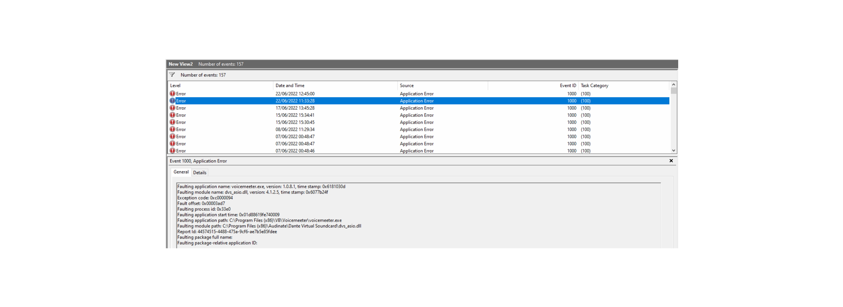

Hi Vincent, apologies for the delayed response!
I believe I am on the latest version of voicemeeter, yes. Crash we're experiencing is 3 - disappearing with no message
Apologies re: picture. Have attached a less-scaled image. I also couldn't read inline but could by right-clicking -> open image in new tab
To attempt to transcribe, it's windows event viewer showing an application error with Event ID 1000.
Faulting application name: Voicemeeter.exe
Version 1.0.8.1
Faulting module name: dvs_asio.dll
Exception code: 0xc000094
Hope that helps, thanks!
-Dean
Version 1.0.8.1
-Dean
- VMEvidence.png (146.99 KiB) Viewed 6740 times
