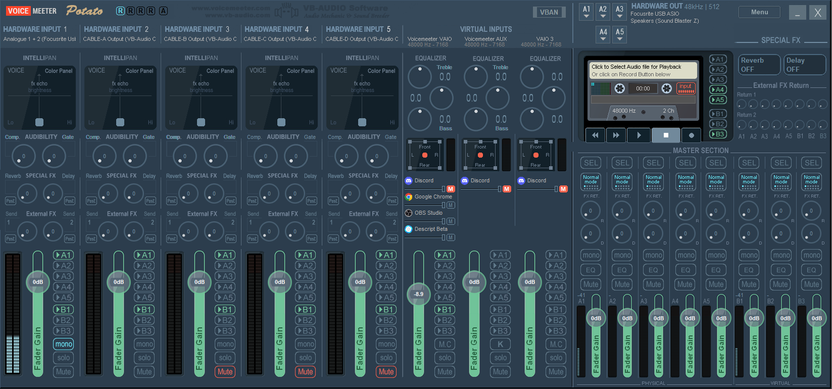

I have multiple instances of a slider for Discord showing on all of the Voicemeeter virtual inputs.
Is this normal? And if not, how can I stop this behaviour?
Here is a screenshot of my Voicemeeter Potato setup:
As you can see, there is an instance of Discord on each virtual input. And sometimes there are even two instances on the same virtual input.

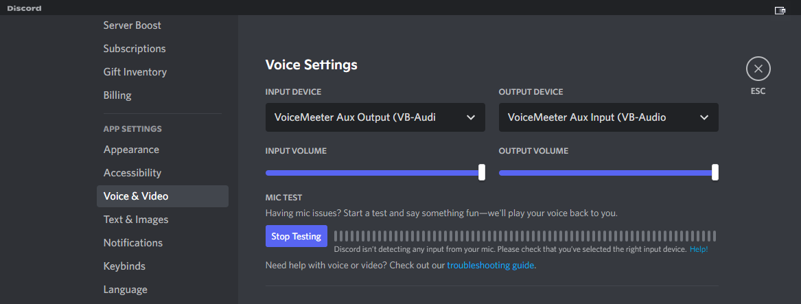

In the Discord settings, I have set the audio input device as: Voicemeeter Aux Output, and I have set the output device as: Voicemeeter Aux Input.
So why is Discord showing on each virtual input in Voicemeeter? Shouldn't it only be showing on the Voicemeeter Aux virtual input?
I have also tried changing the output and input for Discord in the Windows settings under 'App volume and device preferences.
But still, Discord appears on every single virtual input in Voicemeeter rather than only showing, as it should, on the Voicemeeter Aux input.
Am I doing something wrong? Is this a bug? And is there anything I can do to resolve this issue?
