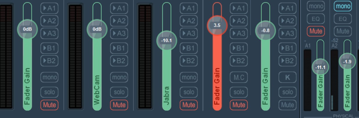

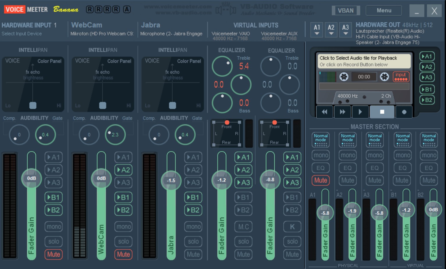

it could mean you have not an optimal configuration, so you may post screenshot of
- Voicemeeter graphic user interface
- Voicemeeter system settings dialog box

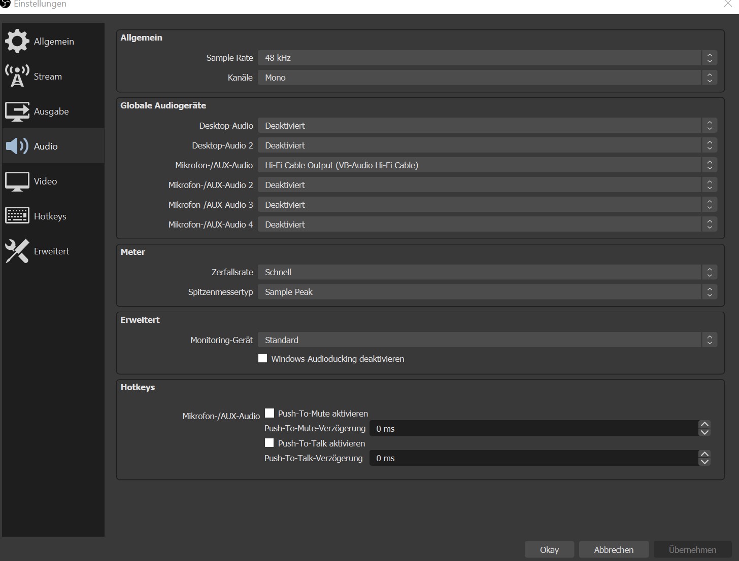

the main problem is the connection to OBS. I did it with VB-Audio HiFi-Cable. All setting seem ok but I get signal drops and a slight slowdown of speech. If I record with the VB recorder it is ok.
And also still having the problem that Banana is completely disturbed and I need to "restart audio engine".

- Posts: 2226
Re: Banana: massive Audio Quality problems
instead of using the HIFI Cable you may connect OBS to Voicemeeter virtual output directly (through BUS B1 or B2)
Windows audio is not stable by design, so one way to fixe it is to simplify the signal path and use more direct connection if possible.
