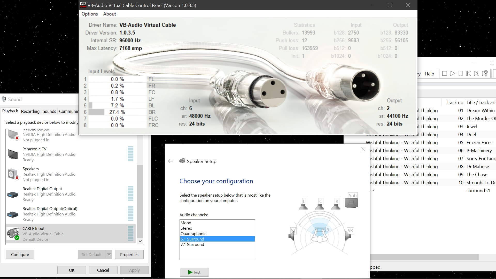

to understand precisely what your problem is, could you post a screenshot of the VBCABLE_ControlPanel, while using the cable with Foobar2000
and check you have configured the VB-CABLE output device in 5.1 (in Windows Sound Dialog box).

I had to shrink my screenshot since the jpg filesize of 400k was too large for the forum to accept.

Re: 5.1 surround audio only playing some channels
Thanks!
- VBcable2.jpg (189.63 KiB) Viewed 27369 times

- Posts: 2214
no, sorry, i don't understand your problem. what is you player ?
As i can see you have some signal on channel 5 and 6 ... why not on 4 first channel.
right click on meters to change the scale to dB
possibly change the internal latency of the cable to 48kH (instead of 96kHz).
(run it in administrator mode to change this parameter and reboot after).
EdisonCarter
- Posts: 12
- Joined: Tue Sep 20, 2022 3:15 am
I was using Foobar2000 to play surround SACD files. The reason there is little signal on the first 4 channels is that the screenshot was during a quiet intro of the song where the sound is moving around the listener, which is why the signal is very small on the front, as it has already moved all the way around to back right and will circle around front again soon. Other parts of the music have more signal on the other channels.

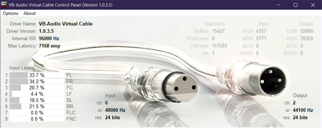

When I have VBCable active, sound is only output in stereo. Is there any way to route just FL and FR to an application through the recording device panel, but still listen in 5.1? Or maybe I need a way to send audio to multiple destinations? Currently, I'm getting stereo output regardless of source material.
I don't know if I need A+B, C+D, VoiceMeeter or something else in order to prevent the stereo mixdown.
I tried this on a different computer with 6 channel 48khz Input, and Output is set to 2 channel 44khz 24bit.
I can't see a way to change Output to 6 channel, so I thought maybe I needed a different product.
Thanks!
Thanks!
- VB Cable.jpg (60.19 KiB) Viewed 27043 times
