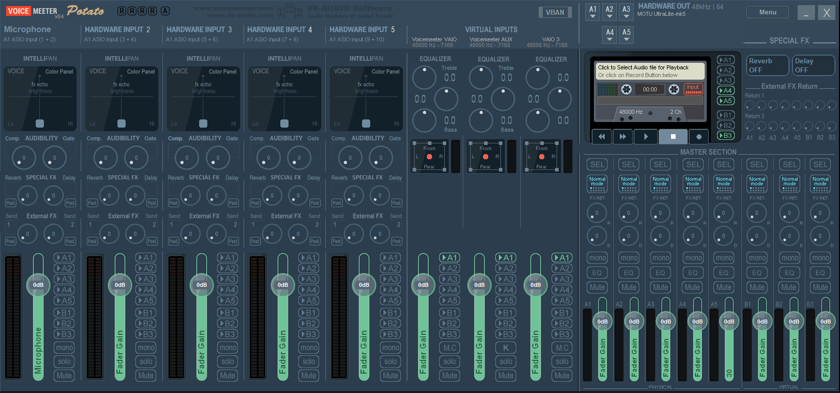

Main window:

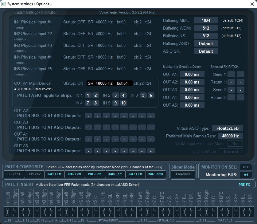

Settings window:
As you can see I have configured hardware input 5 to input channels 9 and 10. Those are called Loopback In 1 and 2. They are used to send a configured source from the device back to the computer. Any input on those channels, Voicemeeter will mirror back to output channels 9 and 10. The mirroring happens regardless whether the channels are configured for a hardware input or not.

Posts: 2184
Re: Potato mirrors two input channels to matching output channels
ok, so if I understand well, you have an ASIO device with 20 inputs and 22 outputs.:
8 first outputs are used by the Voicemeeter BUS A1.
you have patched your 10 first ASIO input channel into the 5 Voicemeeter Hardware Input strip, (but are sent nowhere - not used by Voicemeeter).
and you say that Voicemeeter is sending one by one, ASIO input channels 9 to 20 to ASIO output Channel 9 to 20? right?
(like a passing through process or if there was a 1:1 matrix - for example for monitoring).
Please confirm.

Posts: 2184
ok, right, this is confirmed, ASIO output channels not used by Voicemeeter were forwarding related ASIO input channel.
i will correct this in the next coming version.
