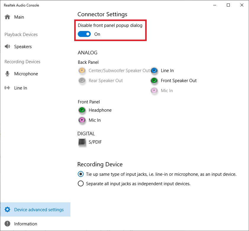

Hi. This is not the answer to your question but a simple comment assuming you are using the motherboard integrated audio solution: In most desktop PCs headphones connect via a 3.5mm stereo jack on front panel which typically includes jack-detection capability. Some audio drivers allows you to disable front panel jack detection which could be helpful is that is your case. One example using Realtek Audio Console:

I should have mentioned that I am on a laptop, so I am using the motherboards integrated sound I assume. I do have RealTek Audio Console, but it tells me that it "Can not detect an RCP service."
But when I plug in my headphones, my sound comes on immediately without VoiceMeeter. I used to have a dialog, but I did something ages ago to get rid of it because I found it annoying. Since the computer automatically knows what to do with the headphones, I don't think this would be the issue.

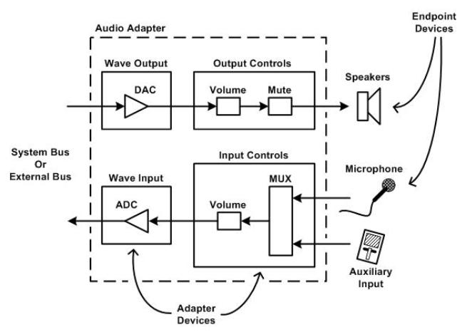

It seems there must be a way around the problem that Vincent has described above, because plug and play is so fundamental to the philosophy of Microsoft in the Windows platform. So at risk of retreading something Vincent has already delved into in his efforts on this (and which may not work as I think it would), here goes:
First (as Vincent will know but others here may not) in Windows Audio API (which he says VoiceMeeter uses) an "Adapter Device" supports one or more "Endpoint Devices" (which may be for example an internal Conexant headset and Conexant mic or something on USB). See attached image. Adapter devices are registered by Window's Plug and Play Manager. Endpoint devices are registered by the Endpoint Manager.
Before enumerating the endpoint devices in the system, the client must first call the API's Windows CoCreateInstance function to create a device enumerator, creating a IMMDeviceEnumerator (a registry of adapter devices). The client then calls the "IMMDeviceEnumerator::EnumAudioEndpoints" method to create a collection of endpoint objects, of which each is an audio endpoint device in the system (e.g. a mic or headphone). After retrieving a collection of endpoint devices, the client can query the properties of the individual endpoint devices. After selecting a suitable device, the client can call the IMMDevice::Activate method to activate the device-specific interfaces in WASAPI, the DeviceTopology API, and the EndpointVolume API.
(Above are summaries of: https://learn.microsoft.com/en-us/windo ... io-devices and https://learn.microsoft.com/en-us/windo ... nt-devices. See also: https://learn.microsoft.com/en-us/windo ... ming-guide.)
So it seems that by polling the above "CoCreateInstance" and/or "IMMDeviceEnumerator::EnumAudioEndpoints" (a doing a bit of extra work) after VoiceMeeter has detected an unplug, it should be able to detect when a selected device has been reconnected by the user. A question with this method is, will either of these calls interrupt the audio stream. E.g., is this like doing VoiceMeeters "Restart Audio Engine", or does this operate independent of a running audio stream?
