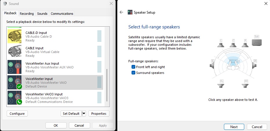

I have three physical output devices on my PC. One is a sound card going to transducers, so I set that to full-range in the Windows sound options. The second is a sound card going to headphones, so I set that to full-range. The third is a GPU HDMI output going to an AVR with 7.1 speakers, so I don't set that to full-range, since I use a subwoofer. However, they can all be using any of the VoiceMeeter channels, so I'm wondering if it's safe to set those to full-range (no cross-over I guess?) or if that would cancel out the cross-over on the HDMI output. Sorry if I'm not asking/explaining that very well.

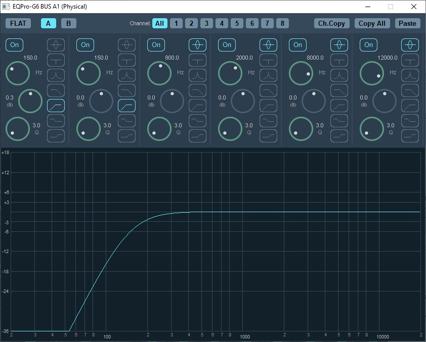

basically, if you need to apply equalization to your 7.1 speakers , you simply can use the Master EQ.
it's a 8 channel (independent) 6 band Full parametric Equalizer , that will let you adjust the sound of each channel as you want.
for example use one or more HPF filter to remove bass on desired speakers (channel):
