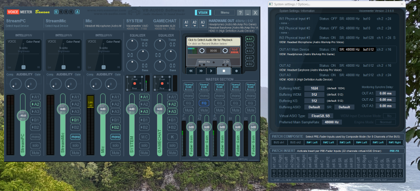

while playing audio, could you post a screenshot of Voicemeeter and its system settings dialog box ?

Sure, see attached.

configuration seems to be ok, so the possible recommendation is to change the audio interface or audio device for output A1 (to find a more stable audio interface MME , ASIO, KS or another audio device).
what is connected to Audio Callback ? click on highlighted 'A' to know it.
