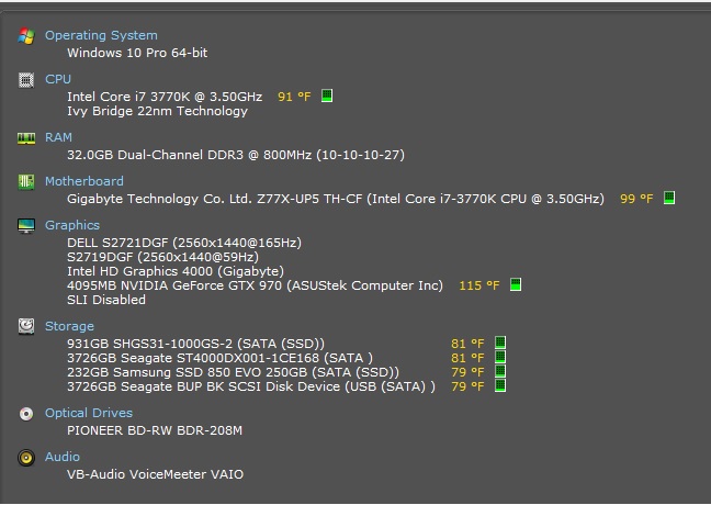

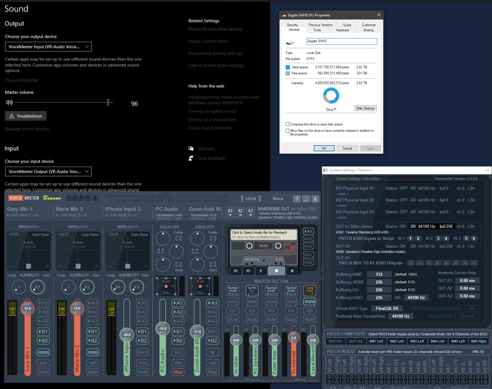

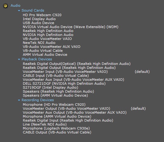

Sometimes my Voicemeeter Banana Tape recorder counter stops. The animation still shows the cassett gears turning and it is still red like it is recording, but when you stop and eject, the file is only one second longer than the recording time shown when it stopped counting.
I'm recording to the same dedicated recording & asset drive for two years, a 4TB Seagate Hybrid Drive { 3726GB Seagate ST4000DX001-1CE168 (SATA ) }
I've been using VM Banana for about three years. This started in the last two months and it does not always happen.

VM & System Audio config.
System Spec-3-Edit System.jpg (510.91 KiB) Viewed 7776 times
Audio Devices
Audio Devices
System Spec-2-Edit System.jpg (85.06 KiB) Viewed 7776 times
System Hardware Specs
System Spec-1-Edit System.jpg (72.59 KiB) Viewed 7776 times
