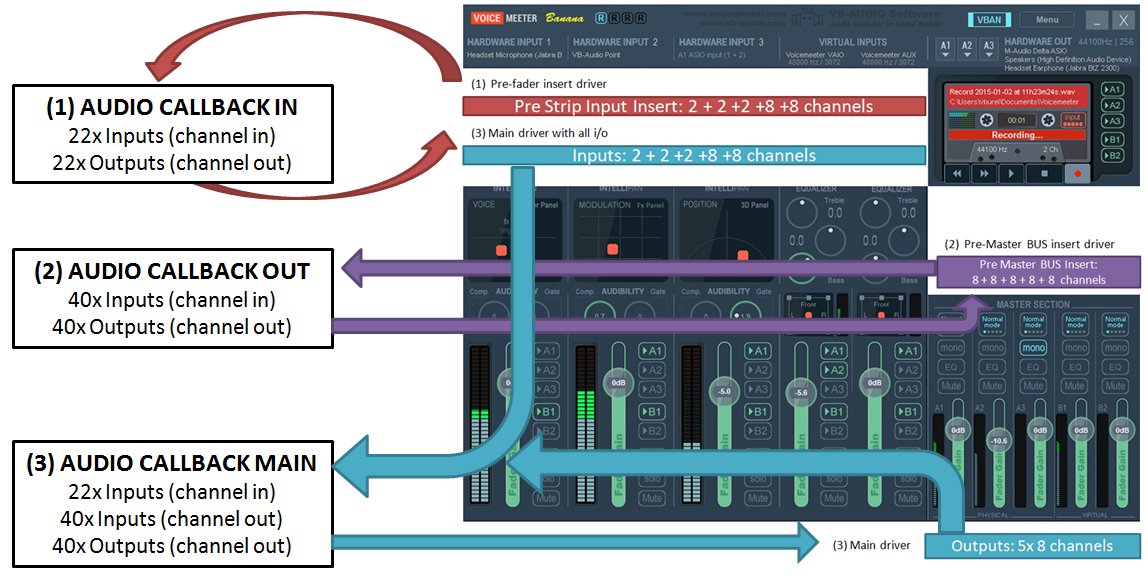

[DEVELOPER] Voicemeeter AUDIO Callback
With Voicemeeter 1.0.4.7 / 2.0.2.4, comes with an important evolution in Voicemeeter Remote API: The AUDIO Callback mechanism providing a new audio API for Windows to process multi channel audio inside Voicemeeter! It means that Developers can now take advantage of the device aggregation and application interconnection made by Voicemeeter, which also manages all audio interface at you place (MME, Direct-X, KS, WDM and ASIO).
Voicemeeter Audio Callback provides 3 possible synchronized Streams (that can be possibly handled by 3 different applications or all by the same) to allow 3 kind of processing: the INPUT INSERT to process all audio sources just before being mixed by Voicemeeter. The OUTPUT INSERT to process all audio busses before master processing. Finally the MAIN STREAM provides all I/O’s (all inputs after insert and all outputs after BUS Fader).
With this new Audio API, it’s is now possible to process audio for any kind of application or use case managed by Voicemeeter Audio Mixer. For educational purpose as well as for prototyping or even commercial application, VB-AUDIO Callback API will allow developer to make their project or processing in few hours… where it needs months to manage regular audio MS-API correctly
VB-Audio API is made of 4 functions only:
