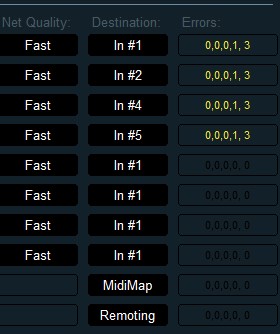

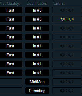

There's no 'red' error blocks, but watching the numbers, there always seems to be numbers here, that gradually go up, over time.. on both computers (dual pc streaming setup).
I've tried many things (changing all incoming/outgoing to optimal/fast/medium/slow, etc inlcuded), but unable to find a way to make the numbers go away. And they seem to be specifically on the incoming streams, on both vban/computers. So, one on the gaming pc, and 4 on the streaming pc.
Any ideas would be appreciated.
VBAN Incoming Stream Error numbers?

- Screenshot 2023-08-19 003315.jpg (25.1 KiB) Viewed 242328 times
- 2023-08-19 00_30_27-Window.png (9.78 KiB) Viewed 242328 times

yes, it count possible error in streaming (for each packet).

What does this mean? How do I fix it, so it stop having error numbers?Vincent Burel wrote: ↑Mon Aug 21, 2023 3:48 pm yes, it count possible error in streaming (for each packet).
My audio has a slightly noticeable 'pop' sound every now and then. Could these errors be causing that?

You cannot get zero error! because just starting or stopping the stream will increase error counter.
The important point is to have a very small amount of error during the streaming.

OH! I did not know that. Thank you! I was unaware. I do hear a small tiny 'pop' of static sound every now and then. Just a brief pop here and there. I've tried to find out what's causing it, but to no avail. I thought maybe the error numbers were causing it.Vincent Burel wrote: ↑Sat Aug 26, 2023 8:21 am You cannot get zero error! because just starting or stopping the stream will increase error counter.

if you hear about cut/pop in the sound, it can be due to VBAN error, but sometimes not.
to be sure it comes from VBAN error, you may see error coming (error counter increased) when hearing the pop / cut.
VBAN single error are expected to be not hearable, but sometimes we can hear a "tic".
